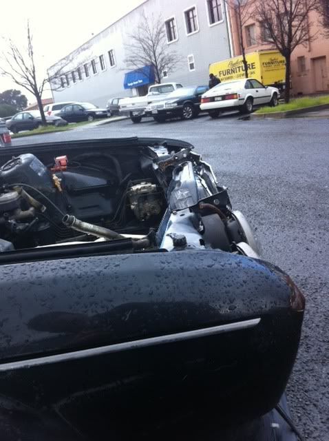

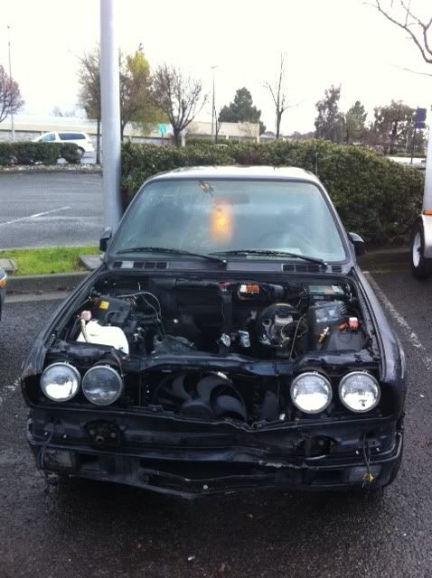

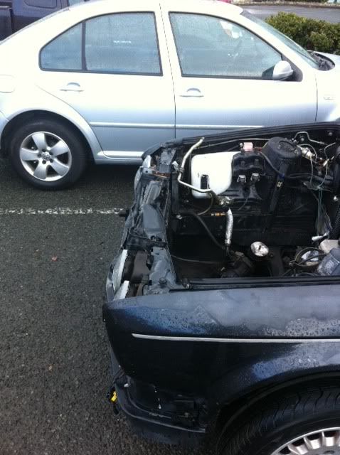

    Ok guys so here is the deal.
    Sweet 91 318is slicktop for sale in my area
    $450 dollars. Has some rear damage that isnt too bad, but this front end damage is what scares me!
    Ive seen a guy on here repair this front support section but cant find the thread
    Would I need a body shop to do this?
    If it cant be repaired I can use some of the parts for my car and part the rest.
    The plan is to make the car Driveable. I am going to use my current salvaged car for parts to make it nice.
    Thanks
    -Craig

    yes Id buy a doner car and cut the rad suport off it and weld it on that one.

      take a picture of the frame rails.
      a core support is replaceable(kinda hard but doable)
      but straighten out frame rails that a different issue.

        Yeah thats what I was thinking. I just not sure if its just the radiator support.
        These are pictures the seller sent to me he is about an hour away.
        So I cant take any pics :(

          Sure it is. Cut out the core support, weld in a new/used one. The rest is bolt on stuff.

                      The core support is pretty easy, however if the frame rails are ganked (and the driver's side one looks like it might be) I'd buy it as a parts car only.

                        Could you indicate what the frame rails are exactly?
                        I have another car that I can take parts from for this car or vice versa.
                        Im negotiating price for this car now.
                        If the price is right ill take it

                          They are the longitudinal rails that run the length of the car. The front ends of them are what the front bumper attach to, just below the high beams. If the ends are just a bit squished, that's not a biggie, however depending on the severity of the hit you may want to look at them more closely under the car for bends/kinks/etc.

                            If its too bad I would have to take it to a shop to straighten it yeah?
                            Thats big bucks

                              Bingo. Also since the subframes attach to them, they may also be damaged too, although those are a bolt-on affair.
