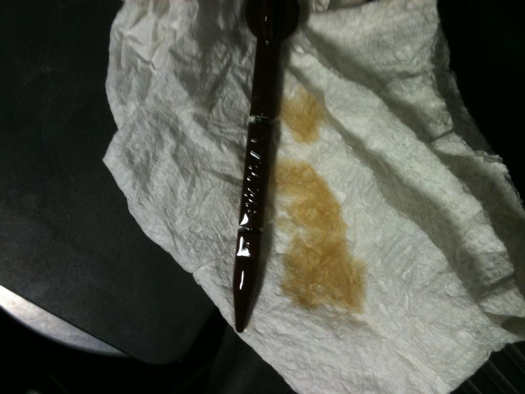

                        I bought my car back in september 2010, this is my first oil change (i know, i know) I filled her back up with rotella 15/40, smells just like my cummins now, lol. Drove her home thirty miles last night and checked the dipstick, to my surprise the engine must be pretty clean inside or it was a synthetic child >? Odometer stopped at 132,000.
