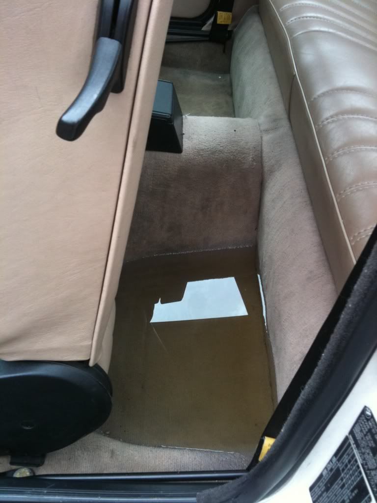

    Okay, so I just had mint comfurt tan carpet installed, as the carpet that was originally in my e30 had about 2 inches of ice beneath it. Well, my cousin drove it and left the sun roof so it wasn't completely sealed all the way. Snow sat on top, it rained, we had an ice storm, and well now, my entire carpet was soaked. I found out the other day and used towels to soak everything up. Luckily (well, as far as luck goes in this case) my car is parked uphill so all the water ran behind the drivers side and is resting in that "well" in front of the drivers back seat. I've been airing it out as much as I can and everywhere else is mostly dry. The back seat, however, has a "puddle of ice" and it's completely frozen. I've heard mixed reviews on whether or not the entire carpet needs to be torn out and I need to purchase a new one, or to keep airing it out on warm days and letting the ice melt and the water evaporate. I would like some actual honest responses from people who own e30's and perhaps have gone through the same unfortunate situation. I hope to hear responses, as I'm not sure what to do at this point. Thanks for taking your time to read!

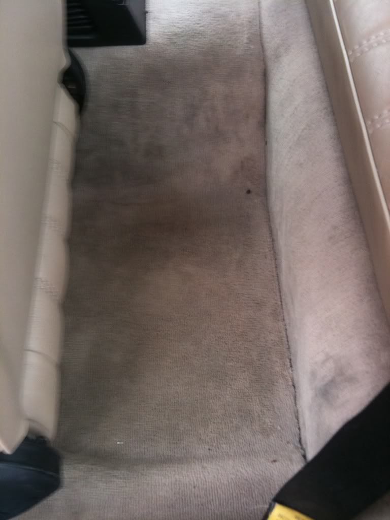

                        So now that all the ice melted I got to scoop about 18 cups of water out today. This Is the best I could do.
                        I scooped water out with a cup, used a towel and a whole roll of papertowels. It's still pretty damp but there isn't much else I can do except take the carpet out, which I'm gonna have to wait to do till tomorrow since it's starting to rain. I can't win lol.
