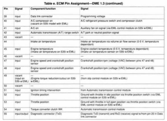

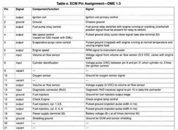

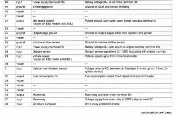

                          well being there is not a diagram telling all the pins and what they do, I would make one. All i really need is tach, O2, Tps, knock, and the air flow input
                          • Jean
                            • 18228
                            Here you go
                            • nando
                              • 34844
                              there is no knock input
