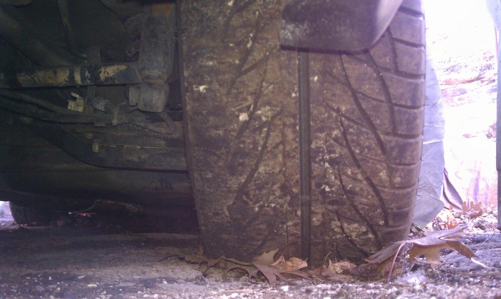

                picture of left rear tire

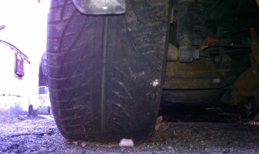

                  right rear
                  • Cabriolet
                    • 9620
                    just go get an alignment. they will print out a sheet of what the final measurement are.

                    • geezerman402
                      • 213
                      Those look like stock shocks, which matched with lowering springs could make the camber wear worse than if you paired a proper set of shocks and springs.
