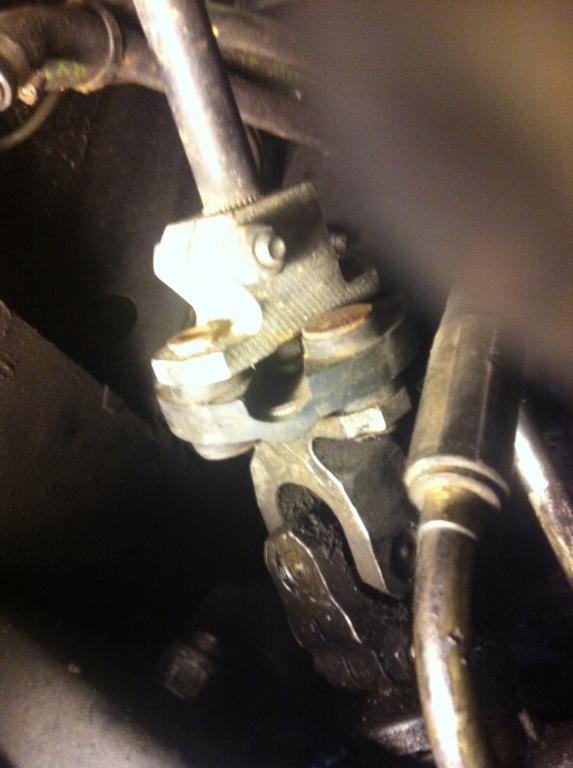

How I checked it was I parked the car, unlocked the steering and twisted it back and forth. There should be no popping, binding, or unequal movement on both sides of the joint.
Steering wheel is wobbly!
Originally posted by b*saint View PostHow I checked it was I parked the car, unlocked the steering and twisted it back and forth. There should be no popping, binding, or unequal movement on both sides of the joint.
What do you mean by unlocked the steering? Taking the steering wheel off? Or leaving the key on on? And what did you twist? The steering wheel? or the u joint?
When I twist the u joint while the steering is locked. Should it move at all? Mine moves VERY little. But I think it is normal because all steering wheels even when they are locked. Correct me if I am wrong?
Originally posted by jjc-hi View PostHere's a pic of my joint from a 90 airbag car. Turns out this is part number 32311156348 Swivel Joint. Now I have to try and get Pelican to exchange the other part they sent me for the correct one. Handn't seen a pic of this joint in previous posts.
[ATTACH]42391[/ATTACH]
is it like this(not my car)
