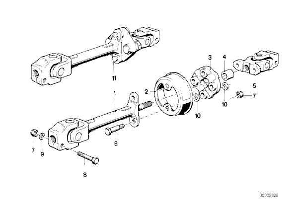

                        I have been working on a similar problem. The lower steering joint assembly on my car is bad. If you crawl under the car and grab it and shake it if it wobbles it's bad. It sits on top of the steering rack and connects to the steering column. I ordered a new one from Pelican, but the wrong one came. Real OEM list two part as the same part number 32311157214. See diagram for #1 and #11. I received #1 which I think is for an 89 and earlier non-airbag model. My car is a 90 with airbag and mine looks like #11. Working with Pelican to try to exchange it.

                        No. Description Supplement Qty From Up To Part Number Price Notes
                        01 LOWER JOINT ASSY 1 09/1984 32311157214 $276.68
                        07 SELF-LOCKING HEX NUT M8 6 07129922716 $0.36
                        08 Hex bolt M8X38 2 32311122041 $0.50
                        09 WAVE WASHER B8 8 07119932095 $0.09
                        11 LOWER JOINT ASSY 1 09/1984 32311157214 $276.68
                          Just saw the video which shows movement in the rubber bushing part #3. The new assembly is solid with no movement. My problem is at the lower U joint where it connects to the rack. This joint is shot, so only when going straight going over bumps the steering rattles. Otherwise the car drives fine and the noise is not noticeable when the steering is in a turned position.
                            Is it suppose to wobble at all? I will check this out tomorrow. Is it easily reachable?
