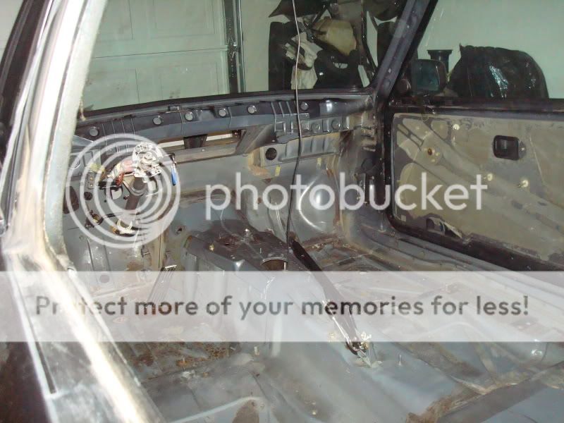

    I'm almost done completely stripping out a e30 m3

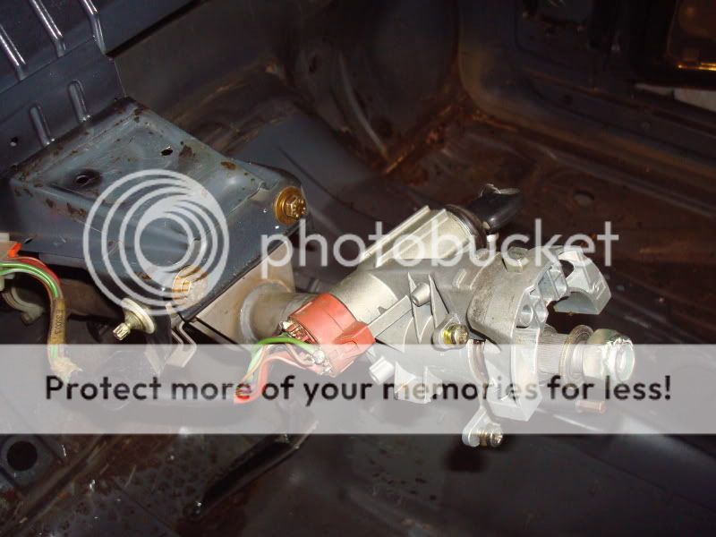

    stuck on the ignition wiring and lock tumbler
    i have heard of sticking a small allen into the tumbler to release.
    i do have the key for it.
    I kinda find it funny i can strip this much out and got stuck on something so small.
    Its currently like this
    stuck here

    I've only ever worked with the older style ignition switches and they had a small allen screw, i'm pretty sure these have the same setup. Give it a shot.

      Look for a small hole at the face of the key slot.
      • schtozo
        • 1455
        You have to turn the key to acc and then stick a piece of hard wire into the lottle hole on the tumbler and press it while kinda wiggling the key along with the inserted wire and it will pull right off. Sometimes it gets kinda bitchy though. As for the switch juat tap both clips and pull it.

            i used a finishing nail for a pneumatic nail gun. everything else was too weak and would bend.
            one of these. i put the key to ACC. put the nail in the tiny hole and tapped it with a hammer. the ignition cylinder just popped right out.

              was not able to get the tumbler out with several different rods, allen wrench, coat hanger
              what other thing can fit in there?

                thanks gda
                ill buy a 1/64 drill bit and try again

                However, I have put off doing the ignition as I couldn't find any info on how to properly get it done and I did not want to destroy the column by just yanking it out with a puller. Well, after finding a post on a euro forum over this past weekend, I was able to knock it out tonight in about 30 minutes.
                Tools used - 1/64" drill bit and small vice grips
                Method - install key and turn the key about 40 to 50deg and using the small pin hole in the gray center section you can insert the drill bit into another access hole recessed about 1/4" into the lock. By pushing the bit another 1/4" with some force it drops the brass retaining pin from its detent in the steering column. See photos below...
                Here you can see the key is almost turned to accessory pos 1 and if you go really slow you will by feel note where the bit can fit into the access slot
                Here is a pic of the lock after removal and you can see how the bit has pulled into the lock the small square brass retaining pin and it sits flush with the lock barrell for easy insertion/removal
                And here is a pic of the bit pulled back just a little to demonstrate how the brass retainer pin pops back up to hold the lock barrell in the column. To insert the new lock I had to insert the key, turn about 50 deg to align the slots so the bit dropped the retainer and then the new lock slid right in.
