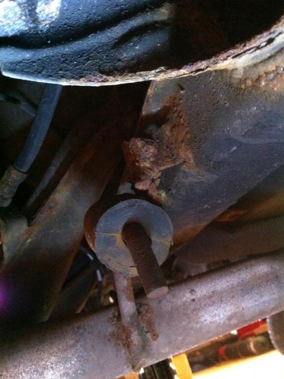

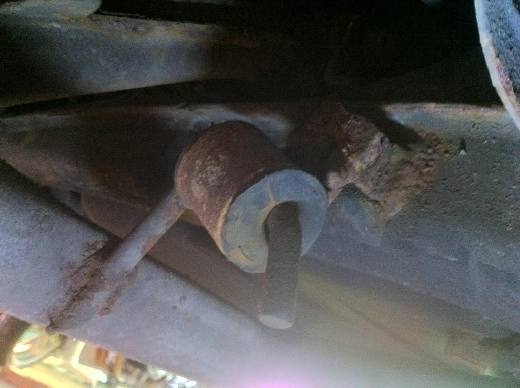

              there's 4 mounting points for the rear section. 2 donuts, 1 bushing like thing, and the clamp to the front section.
              i have removed all except the bushing thing. i can't figure out how to get it out. it looks kinda like it would slide out but i couldn't seem to get it out. it's bent at too much of an angle. here's pics of what i'm talking about:

                Try bending it a little to help the angle, it should slide out maybe try some WD40 on it so it can slide. When reinstalling bend it back to how it looks now i guess

                  Wow, no idea...that does NOT look stock. looks very bodged on...

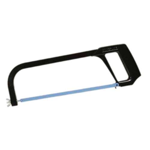

                      OR!!!
                      OR!!!
                      OR!!!
                      OR!!!
                      Honestly. Just use the sawzall
                      Leave Me Transaction Feedback
                      • brutus87
                        • 6280
                        With your bare hands like a goddamned man.

                              sawzall... without a doubt.
