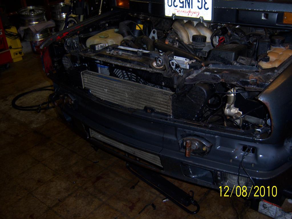

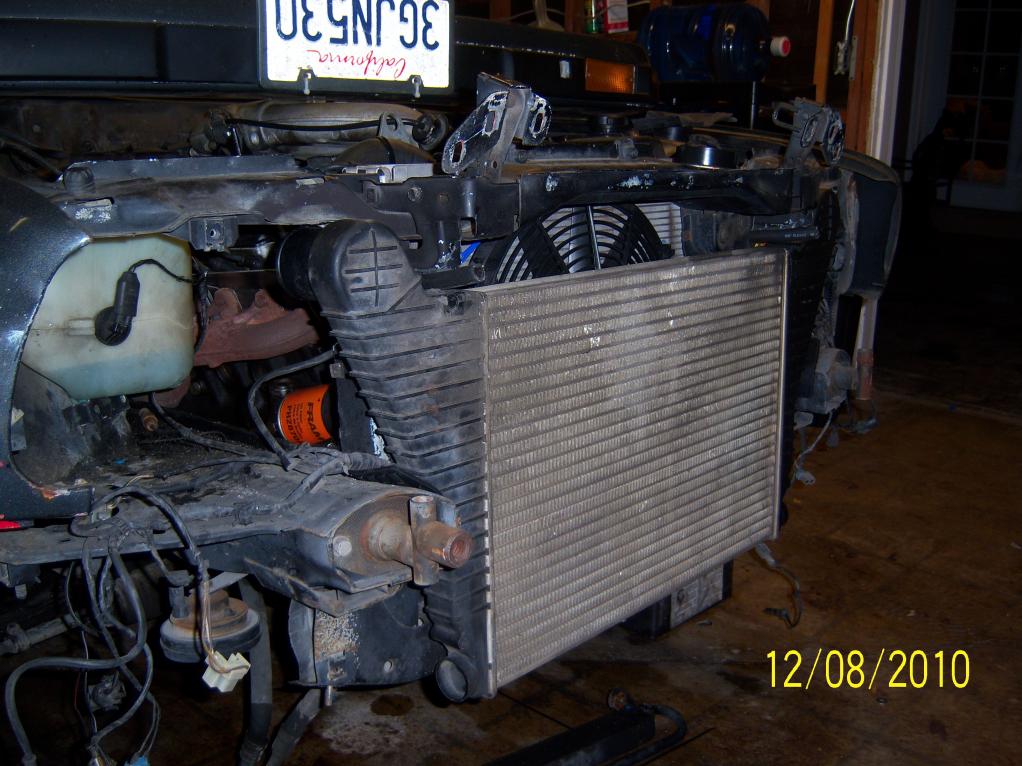

                          I'm just running the stock rad and a volvo intercooler at 9lbs boost
                          here in Socal, I'm running a 10* lower thermostate and a independant fan temp switch. I have yet to get a tick above 180*
                          If you look at the lower rad hose you'll see my oil cooler. It sits
                          just below and behind the rad works really well.
                          It all button's up qutie nicely...:up:
