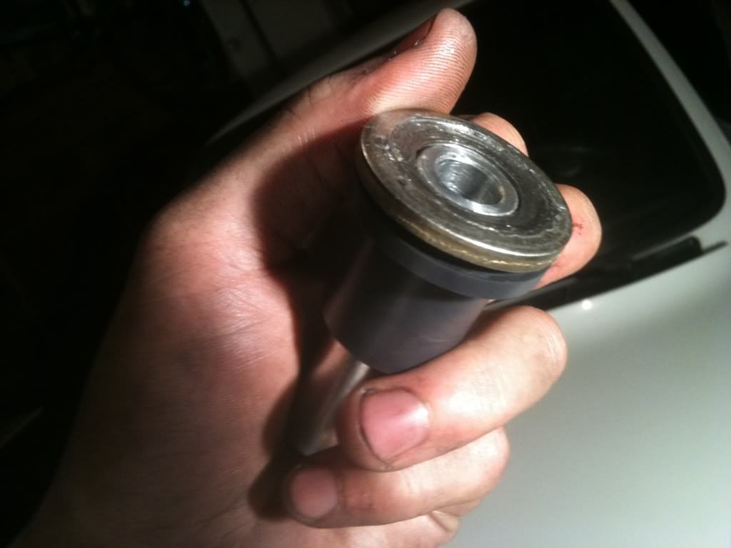

              Im just about fed up. Now the akg's won't go in. I even used silicone grease, my press, drilled air pressure release holes and installed exactly the way the pictures show on the website. I managed to get ONE of four in properly. I'm about to fucking lose it...

                  even the washer I'm using is perfectly sized to fit over the shank.

                  • LJ851
                    • 7919
                    I hate to break it to you, but its you not the bushings. This is not rocket science.

                    • Brandon12V
                      • 1318
                      so tell me what I'm doing wrong.

                      • LJ851
                        • 7919
                        im not sure, im not there. what is the ID of your trailing arm? What is the OD of your bushes?

                        • LJ851
                          • 7919
                          I would push the bushes in first and then insert the center sleeve.

                          • Brandon12V
                            • 1318
                            try again, lol. it was the first way I attempted to install them. then I resulted to checking the website.

                              • 36brua
                                • 689
                                your photo shows all thread between the bushings. I used a 10or12 mm bolt fine thread w/ hardened washers w/ anti seize heavy nut, cranked them in . ea arm independently. the rod pushing on the other bushing can cause misalignment of the bushing and can distort /spread the arms if too much pressure is appled. GL
