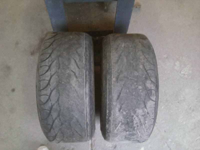

    My first post... I have a 1987 325is, I bought it about a year ago from a kid that was pretty young and I don't think he knew too much about cars. The wheels are 17x7 with 40mm offset and the tires are 205/40/zr17 and the car is lowered about 1.5 inches(?). The rear tires are completely messed up. The inner sides of the rear tires where the tread meets the sidewall is pretty much gone with the wires showing and everything. Could this be because the wheels have such a high offset or is my frame messed up? I figured maybe the inners of the tires were scrubbing something in the fender well maybe when I hit bumps or something. The guy at firestone said my frame wasn't straight, but I really don't want to believe that especially because my car was never wrecked and the guy seemed kind of lazy. please help.

        The wheels are sunk deep into the wheel wells.. The wheels look completely straight. They don't look cambered at all, and the tires are planted flat on the ground on both sides of the wheels.
        • dougiefresh369
          • Aug 2011
          • 10
          Actually they are a little cambered. But the amount of wear on the corner just seems so excessive compared to the rest of the tread, it doesn't seem right.

                        pics?
                        does it look like this??

                              @OP is it like this:
                              Or like the photo bloodshot posted?
