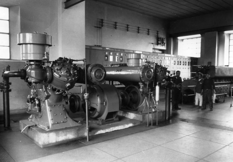

              I also used to work on these Joy WN112's with my dad. My dad is not in the picture lol but its good for a size reference.
              In old paper mill towns in Massachusetts, some places still run these as they are more efficient than rotary screw (they make air on the up and down stroke hence "double acting.") Lately tho, the cost of maintenance and parts has been retiring these bad boys. The Joy's were so well made, when they unloaded, you could balance a penny on end on the heads.
