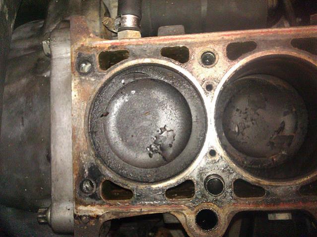

    Well now im wondering how I can clean out more gook from the motor without taking it all apart. I saw this from Robbies daily turbo build around the time I started my build thread and have no reason to believe mine will look any better.

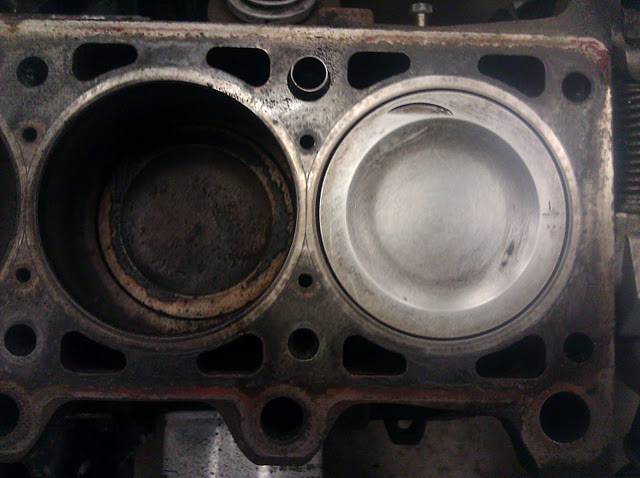

    and with some elbow grease he got one clean followed by the rest
    Should I even expect any of these products to do anywhere as good as pulling it all apart. Ive put seafoam in my oil and run it for my last 100 miles before an oil change but zMAX always seemed so expensive. Then I read the website and the "technology" in it and am starting to believe it may help
    Anyone have some kind of some kind of miracle story for any of the 3?
    Are they all just out for my money and dont really do anything?
    please share...

    why, actually carbon build-up is raising your compression (not anything noticable) but it isn't hurting anything either.
    his pistons are going to look the same after a few thousand miles anyway.
      It won't benefit you anything. It may actually make matters worse.
      If it ain't broke. Don't fix it.
      Also. If zmax gets on top of your pistons. You have issues to deal with.

                well if you've ever worked on a motor with a blown headgasket you will see the best way to decarbonize the combustion chamber is with coolant as the piston in the leaking cylinder will be nice and clean just like that one in pics above. not that i recommend it but it does the best job . ive seen turbo motors running water injection and chambers are always nice and clean at rebuild time,of course they see lots of maintenance with frequent oil changes
                  Funny you mention it, an old school way for cleaning out carburated engines was to drizzle some water down the throat of the carb...took a chance in messing up the motor, but sure cleaned things up. You could grab a vac hose and do it with these motors as well, but you REALLY need to be careful and monitor how much water is going in (a lot easier drizzling it down a carb throat) too much and your going to hydro lock the motor and bend some rods.
                  -Build http://www.r3vlimited.com/board/showthread.php?t=295277
                    that's not really old school.
                    we still do it all the time in the rotary community. you cant hydrolock a rotary though. it steam cleans the engine!
