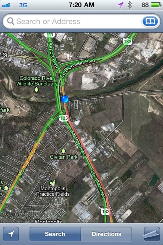

    This was the result, the blue dot is me: (The red part ended up going a further 5 miles down 2 different highways later.)

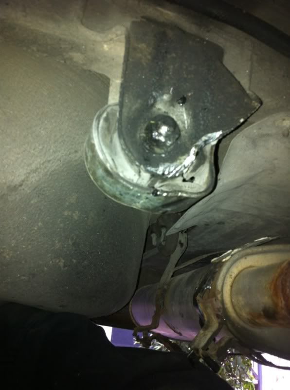

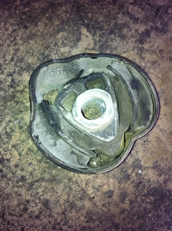

    I'm thinking 2 possible scenarios.

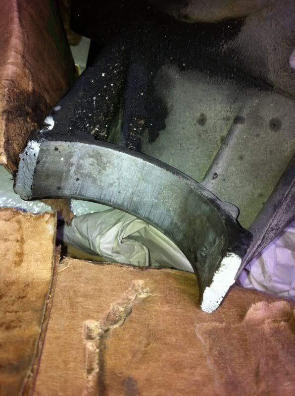

    1. I destroyed, literally, my oil pan on a nasty dip at an intersection a few days before. The force from the impact sheared my diff mount in half. CV axles were now at a weird angle causing stress/vibrations/etc and worked itself loose. I was at highway speeds that morning and I don't recall feeling anything. This was the first time driving it after replacing the pan.

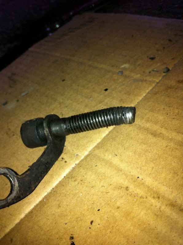

    2. My CV axle was already loose and chose that moment to fly off. I have had a random vibration every now and then coming from the rear above 80 mph. I figured it was a wheel bearing.
    My CV bolts were blue locktited and impacted on. I've discovered them to be hand tight when I first got the car so I didn't want to take any chances.

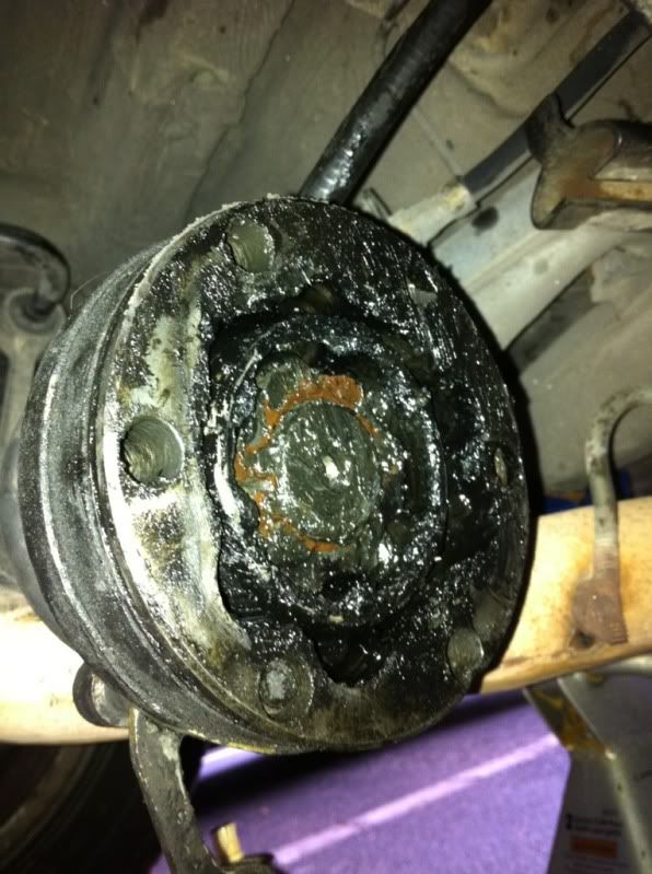

    The CV axle that came loose:

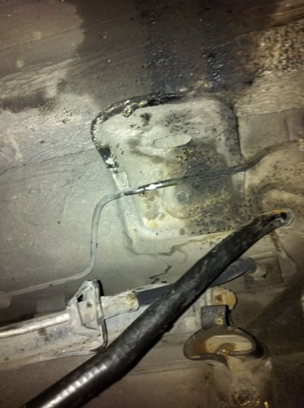

    When the CV axle came loose it whacked the underside of the car then wrapped itself around the emergency brake cable. I ended up having to undo the cable inside of car to get it off of the tow truck. I'm having to replace a CV axle, my diff ,and had to hammer my diff mount on the body back into the right spot.

                  I don't think impacting the bolts is the right way in this case. If the threads (male and female) were clean then they should have held. When it comes to tightening certain critical festeners you have to hand tighten with a torque wrench if possible and then double check. I once had a rear wheel come off a vehicle that I tightened using just an impact gun. Now I check the torque by hand.
