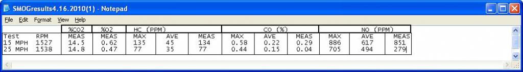

                  Please dig, I need to smog mine soon. My number will be through the fckn roof I have a feeling.
                  Recently found a rip in the intake boot too :hitler:

                      Sorry for the jenky ms paint and notepad mashup but these are the number i smogged on 4/2010 for my eta, Im sure it got plenty worse.
