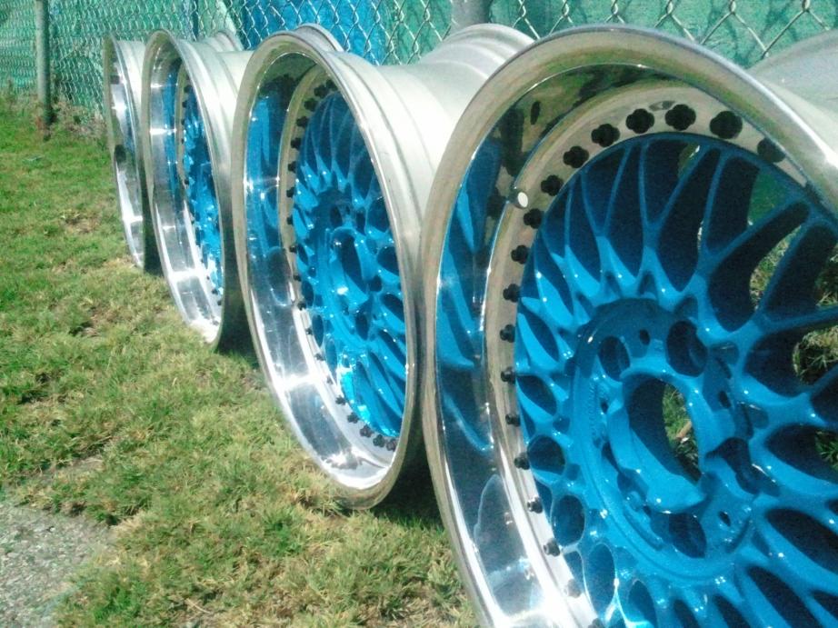

      Well, the bolts have been sitting in vinegar for almost a week now. They look SOOOO much better.. now time to buff them up!

                        The bolts/nuts have been sitting in vinegar for exactly a week now. I think ill be swapping out the vinegar tonight and let them sit in some fresh vinegar for another few days.
                        As for the rims, I've been slacking on them. Had a few problems come up and couldn't really work on them much. I tried paint remover, and it didn't work for crap. Then I got some heavy duty easy off and it pulled like 75% of the clear coat off. The only problem I had with the easy off was the amount of oxidation that was created. They looked HORRIBLE(ill have pics soon). Tried to polish it off, but wasn't working well at all. The next day, just went and bought sand paper. Since my e30's not running yet, I got a friend that decided to bring his mkI rabbit over and mount these on. Raised the car up, and put it into 3rd gear. Used grid 200>500>1000>1200>2000. Will need to get a higher grid paper for that last finishing touch. Let me tell you, AMAZING results. We just did one rim, and for a first time, it went great. Will need to do a better job on the corners and around the bolt holes. I'll have pictures soon.
