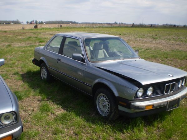

    i'm about to get a 1986 325e
    i'm new to the BMW's i come from the land of Volkswagens!
    but the car i am getting is pretty clean. guy put a running engine in the car. it cranks but doesn't start. now i honestly do not know any information on the car besides it cranks over and doesn't start. i was just wanting to know if there would be anything to check first, obviously spark, and if she is getting fuel. but maybe some kind of other problems these cars may have.
    any information would be nice. thank you.
    this is her. paying 700$ for it.

        I would start replacing simple things such as; Spark plugs, distributor cap /rotor, and fuel filter. All fairly cheap fixes and worth replacing on newly purchased e30s. With any luck after replacing these she may just fire right up. Nice find btw. :up:

                Cant beat that price! It looks clean from that pic, hope you get that issue resolved with it.
