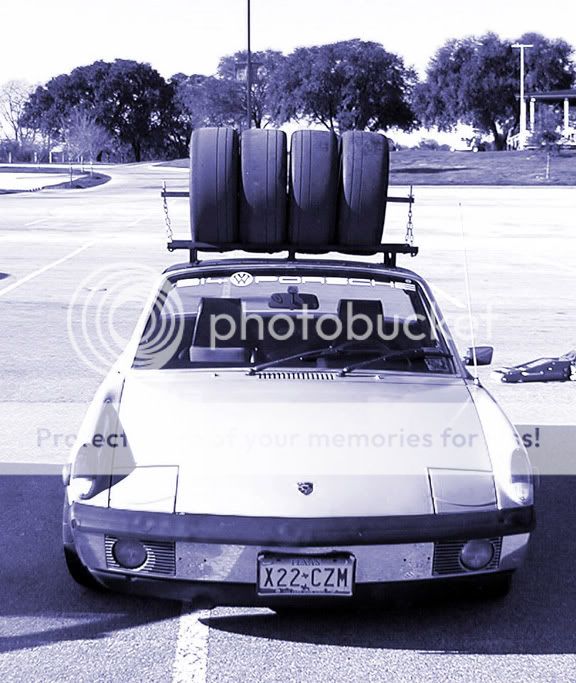

    something like this should work
    mount the roof rack bars closer together so the wheel is held by it, then secure the wheels.

        I did it similar to the Porsche pic. I bought some half inch steel bar stock, drilled holes for u-bolts to tie the bars together, where the wheels would sit about an inch from the roof. I cut the bar stock a little long so that my straps could tie to them. I will try to get a pic...
        Also mounted the tires as far back as possible so that I could open my sunroof without accidentally damaging it, but wind noise with it open either way was terrible.

            You could just mount your load bars close enough to cradle the wheels and tires, then just strap em down.
                Just a heads up, if you don't tie the bars together, there is alot of torque on the roof from the bars being shoved apart. I only put 3 tiers on the roof because all 4 up there is close to 150lbs, up high, and the mount that ties to the lower gutter mount is not long, only the top is on the yakima and thule racks. I wanted to be prepared if I rear-ended someone...I also strapped as close to the bar/wheels as possible instead of through the centerbore just incase the rear strap broke, there would be less of a pendulum.

                      I did the above mentioned thing with Yakima cross bars. I put 4 275s across the roof. To alleviate wind noise and improve mileage I made a spoiler to get air over the tires.
                      I always ran to tie down ropes through the center bores to hold them down. I never had the bars move to much. as I crossed the ropes so the squeezed the bars together or kept them from splitting......
