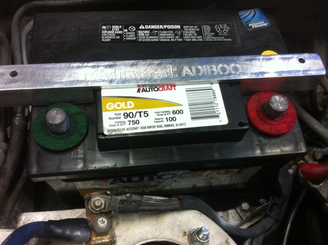

Was bored at work, so made this.

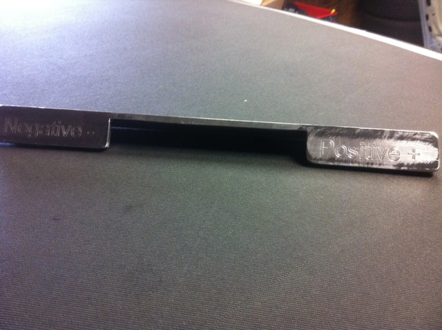

    Before I installed it I put some leather on the positive side to protect against accidental arcing. Used stainless 1/4 inch bolts to mount it to the tray. Total cost $14.

      Looks cool. I wouldn't trust that back there.

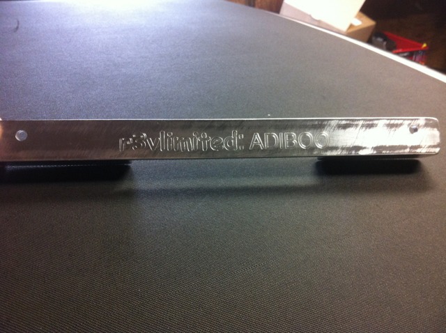

        Couldn't find a better font then comic sans for r3v? Lol sorry but that font sucks
        I'm a typography nut
        Cool idea though!

          Short circuit bar? Looks pretty dangerous.

              Thanks, I'll see if the engraver has that font, if so I'll grind it down and use it. As far as the shorting problem, I have leather over the positive side right now. But today I'm planning on dipping it into some bed liner a couple times.

                    I think impact or just reg. Helvetia would look good.

                      When I bought my E30 it came with a battery clamp like this. First spirited drive and it short circuited my batter terminals and made the car stall.

                        Got a couple coats of bed liner on the positive side now just for peace of mind. But with the way it's bolted down there's nearly zero movement.
