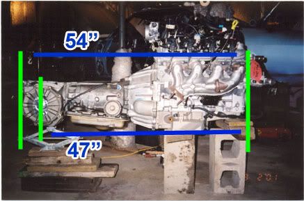

                You don't see them in kit car applications because the vette transaxle isn't 'really' a transaxle. It's still the standard t56/tr6060 longitudinal mounted just instead of a tail shaft housing, it has a small differential mounted directly to it. Even the clutch is still up at the engine side. Makes the whole package very, very long for any application other than corvette.

                  C5 transaxle bolted straight to the LS1 at 47" back, it doesn't even look like the 47" is including any accessories.

                      Ok I just now read what you guys are saying about the length of it, that really puts a damper on things...
                      At a certain point, with accessories in front you could reasonably expect it to be another 8" tacked on up front of the motor. Then you need space for a sort of firewall to keep it off your backside, plus seats, etc..

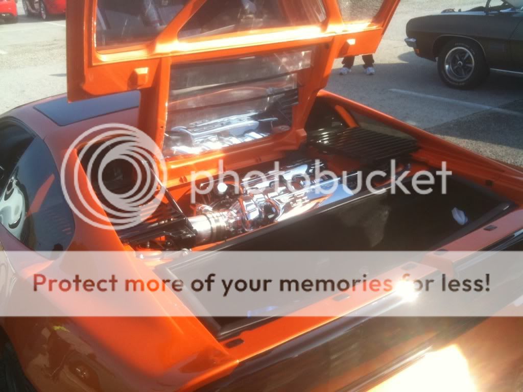

                          • Cabriolet
                            • 9620
                            a friend of mine did a LS1 in a fiero. sideways. looks like this guy's build: http://ls1tech.com/forums/conversion...iero-swap.html
                            Much wow
                            I hate 4 doors
