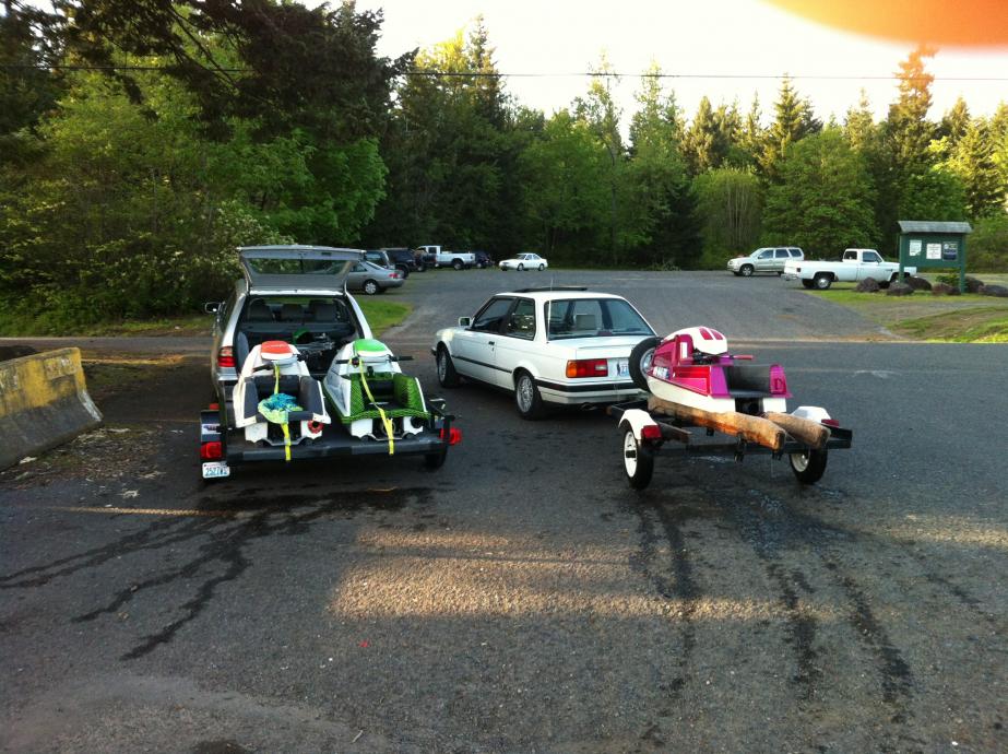

                  Anyways, an e30 can easily haul a single ski and small trailer. Back in the day my dad hauled his ski with his '85 eta. Last year, a friend of mine had a tow hitch installed to the back of his e30 by a local shop. All they had to do is weld the bracket that holds the hitch on to the rear and it held very nicely. He's in the military or else I would have him give you the details on how it's set up.
                  Here is a picture. That's me pulling two yamaha superjets with the wagon. My friend is pulling his kawasaki 450 with his 318is. We launch off a ramp with a bit of a slope and his 318 has a enough pull to get the trailer up it.
