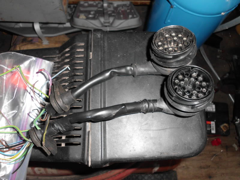

                      My concern is wiring and wiring diagrams. Bentley shows a change mid-'86.
                      Is this the C101? Can't find a square plug pic to compare. I'm at work without the manual.
                      Thanks -
                      • B Randon
                        • 2569
                        Thanks -
                        yes that is the round body side c101, i should know that is my pic lol

                          Funny - that was a random google image search. Thanks for the help - I will check it when we get back to the car. Seems the key change was the exciter circuit running from the cluster charging light - mid-year they put a resistor around the bulb so the alt would still charge when the bulb burns out.

                            It's the round one.
