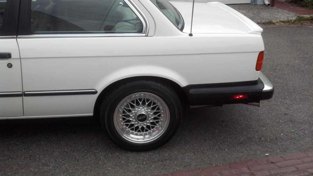

                      we got the rears done, hopefully the fronts on Saturday.
                      Well my buddy Tom W. and I got the rears banged out on Wednesday shop night... I'm happy with the way the rear sits... wish we had time to do the fronts.... more updates to come... H & R blue springs and BILSTEIN sports ...
