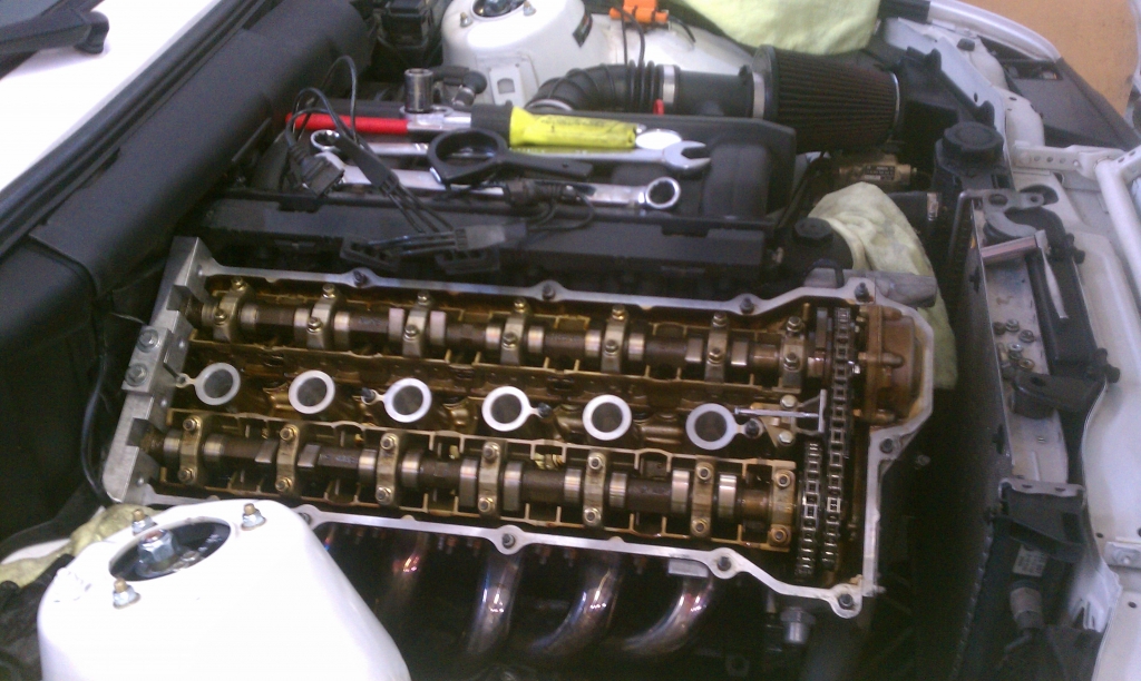

        Even with a blown head gasket this thing pulled like a bat out of hell! With every maintenance item out of the way, I should have as you said, a very reliable engine. I don't know what it is putting down to the wheels, but lets just say it's atleast 2x as fast as that lethargic eta I had before.
        I don't think I have uploaded a pic before. So I will leave this here. :early:
