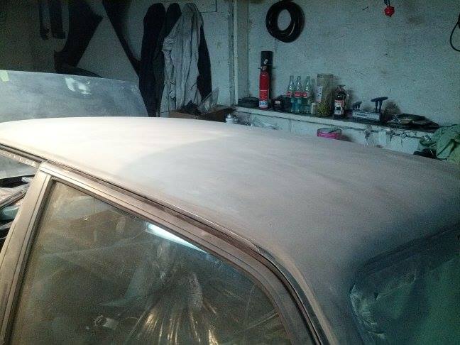

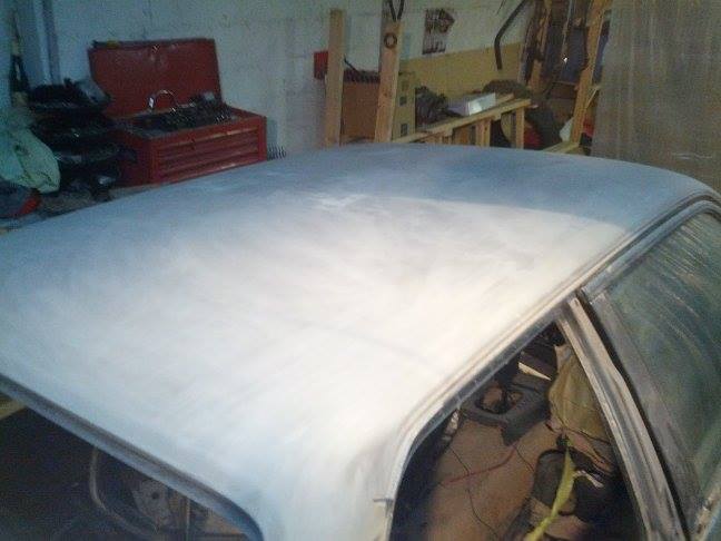

                        Pics of my delete. It's for a race car so I didn't bother to make it perfect, just panel bond and a little filler.
