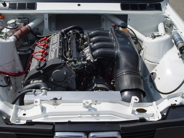

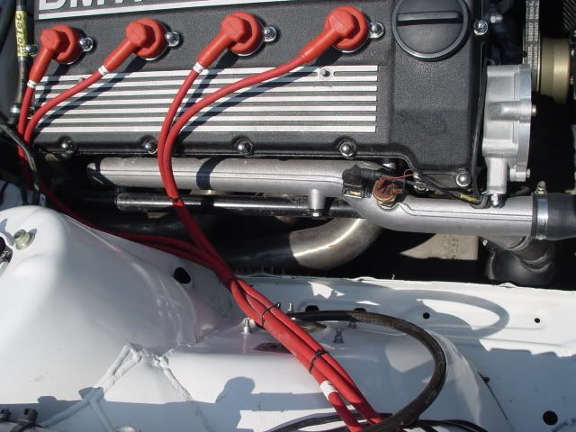

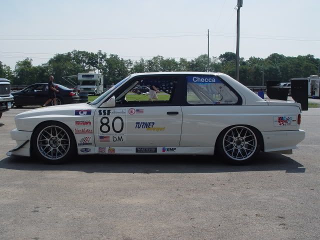

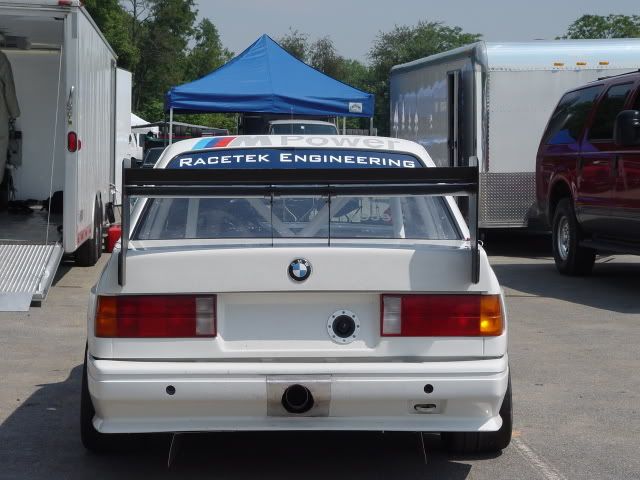

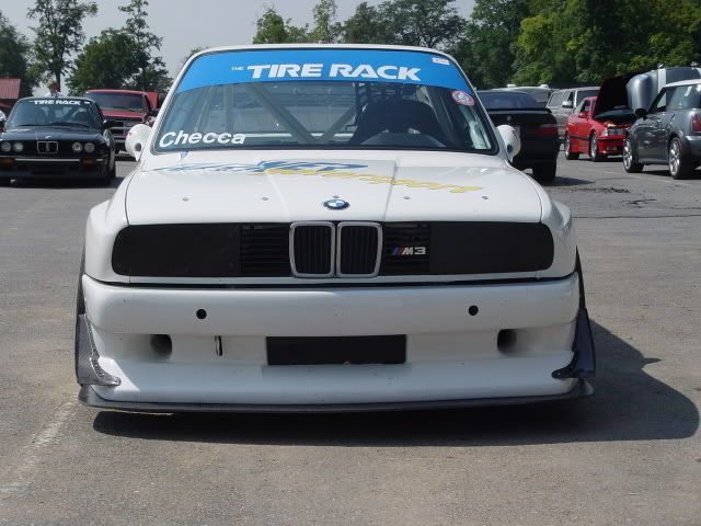

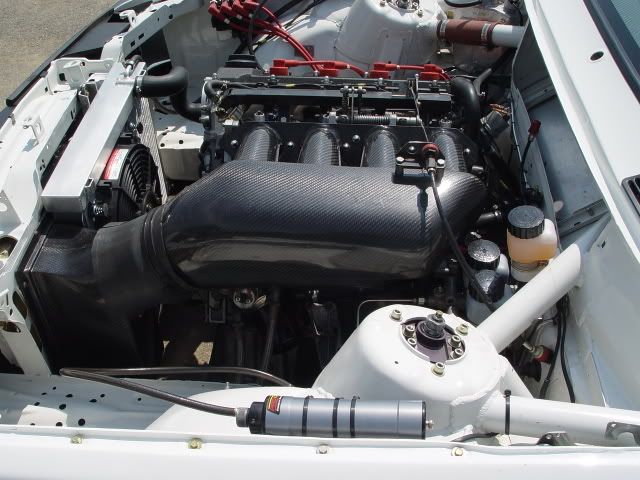

                            • bmw332i
                              • 229
                              Ron Checca has a monster s14. It makes around 350 crank hp. I had Ron as my DE instructor at a GVC BMWCCA event once, and his car was there. I took some pics of it. He says that he rebuilds it about once a season. As far as reliability, he says it's pretty good. The thing is insanely fast. I can't imagine what one of his engines would be like in a race-prepped 2002.
                              Pics!!:
