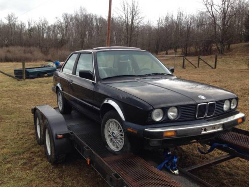

                Thanks everyone for the advise, me and my dad went to look at it and we bought for a nice $500. The car had some decent rust but nothing to bad. Looks I have another project along with the other one.

                  $500 for just about any e30 these days is a deal, despite what you might read on here. Looks like a nice score.

                    Thanks ,it really was a great deal.
