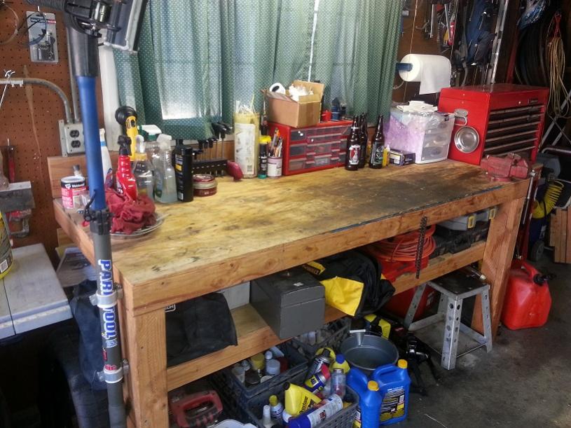

                            Something that I've done a couple of times is using an old solid door, surrounding it with 2x4s then topping it with plywood. This design has 3 advantages:
                            1. You can cut the door to any size you wish.
                            2. You can swap out the plywood top if it gets torn up or nasty.
                            3. It's strong as hell!
                            Here's a picture. (ignore the mess)
