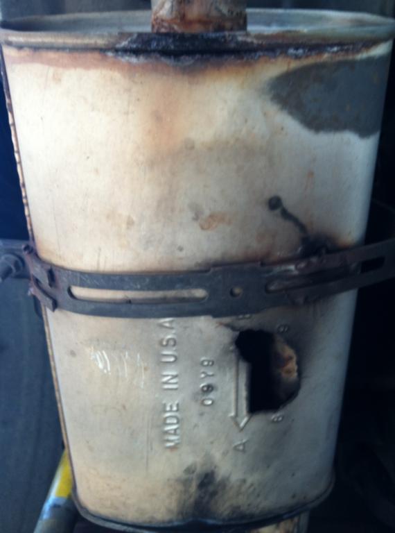

                      So i found my exhaust leak. Shit isnt pretty at all :(
                      Anybody have an exhaust for sale?
