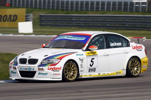

                          E90 320si Airwaves BMW #5 and #11 run rear camber that makes "stanceworks" guys jealous so that isn't entirely true, -3 is a tad much though. Slightly tightening up your rear end will help with the tail happiness as-well as wider softer rubber. A Z4 rack will make a big difference over the E36 M3 one, finding and paying for one is a different issue. Don't be afraid to strip her out, mine went from 2,800lbs to 2,520lbs and I wasn't even done yet.
