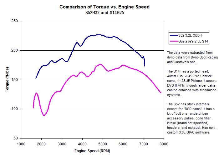

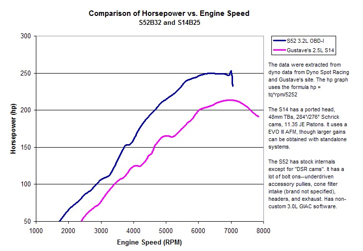

                    I've done a paper dyno comparison between Gustave's S14B25 (which at the time of its dyno, did not have Alpha N) and a S52B32 with cams and most bolt on mods, but stock 3.0L software.
                    The key to both daily driving and occasional DEs is not peak horsepower. The key is the area under either torque or hp curves. The 3.2/3.0 have essentially the same shape to their curve, but the 3.2 has more torque. Between 3K and 6K the S52 has around 50 lbs-ft more torque.
                    If I owned a functioning E30 M3, I'd leave the engine as-is. If I had low comp because of worn parts, I'd do a partial or complete rebuild depending on what needed work. If the motor grenaded, leaving me with few rebuildable parts, I'd think about a S50 swap. If I had a M42 in a 318is starting to show signs of age, I'd do an S50 swap. Which is what I'm doing right now. :D

                        Nice chart there Fred- can you show the hp graph, too?

                          Here's a quick and dirty hp comparison. I didn't get the hp from each dyno plot. I used the formula hp = tq*engine speed / 5252.
                          Take it for what it's worth, just a dyno plot. It won't necessarily tell the story on the racetrack or even "in the twisties."

                              excellent graph. My 2.5 is built bassically exactly to Gustaves specs - almost exactly copied his motor.
