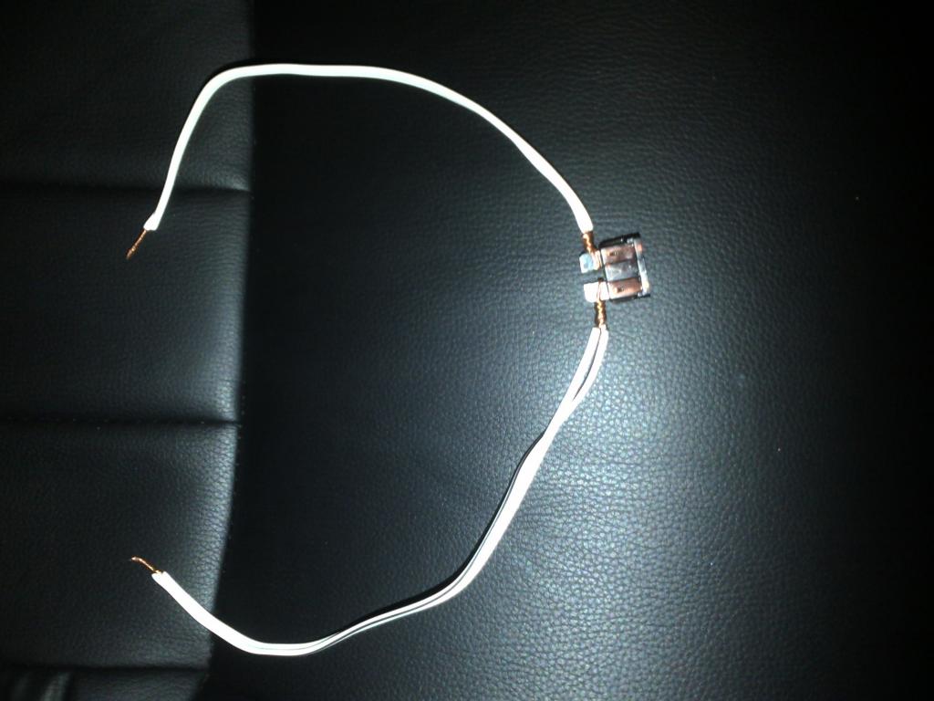

                      • IceWhite
                        • Jan 2015
                        • 945
                        This ghetto "stranded on the side of the road" mod could have saved you.

                        • AndrewBird
                          The Mad Scientist
                          • 11898
                          This is EXACTLY why you are supposed to use a fused wire.
