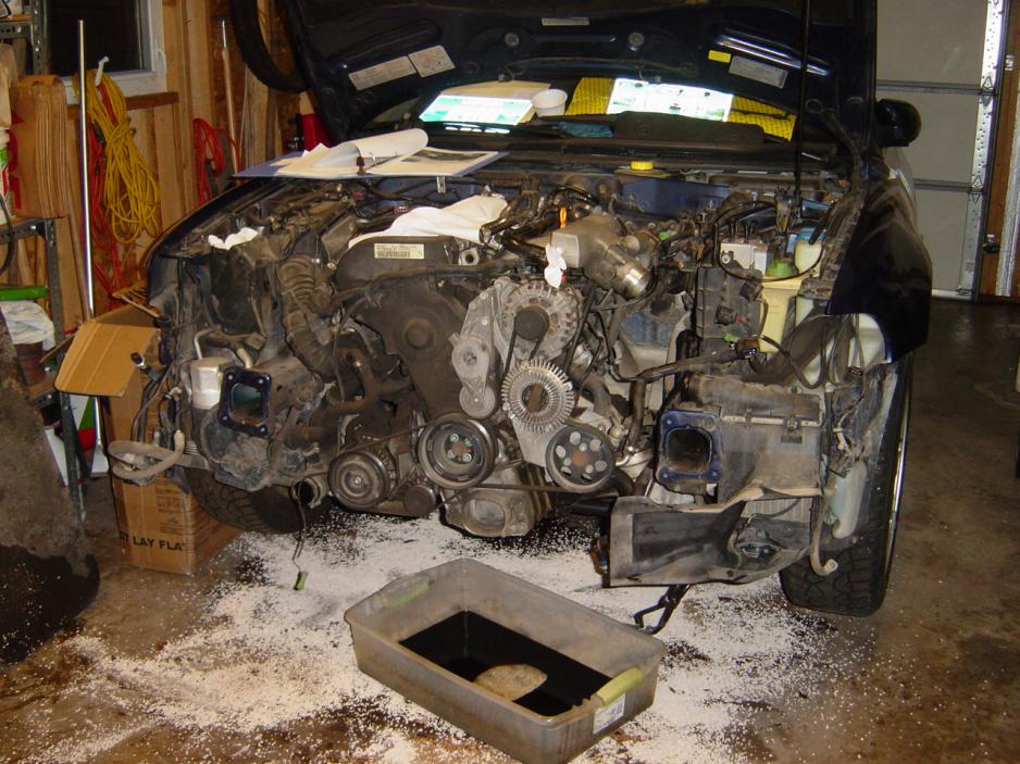

                          I have an 01 B5 A4 Avant 1.8 manual. I LOVE the looks of the newer body you're looking at. I believe they dealt with the sludging disaster of the 1.8 after buying so many engines for customers - I think there was a class action lawsuit against VW after the warranties ran out and engines were failing.
                          Mine has 130k and of course way out of warranty. I bought it used, one-owner, dealer-maintained. I just finished putting a new used engine in myself after mine ate rod bearings and threw a rod out the bottom of the pan.
                          The problem with that specific engine was that the pan had to fit around a big cross-member, so they made the capacity smaller. The Passat and sideways Golf configuration were better.
                          3 1/2 quarts of oil, turbo boost, oil-to-water oil cooler, very tight packaging, and complicated systems meant they were very susceptible to oil sludging. Oil change interval was too long even with synthetic. Filter was tiny.
                          I took really good care of it, regular synthetic changes, etc, but it let go with no warning. The packaging made it the most complicated car repair I've ever tried. Runs great now, everything except the long block is new. I use the newer huge oil filter that holds an extra half quart, and I'll change it at 3000.
                          The quattro system is the best bad weather / snow / ice system I've ever used. (Soob is maybe close behind).
                          SO….buy one with very good service history and receipts, and even then be careful.
