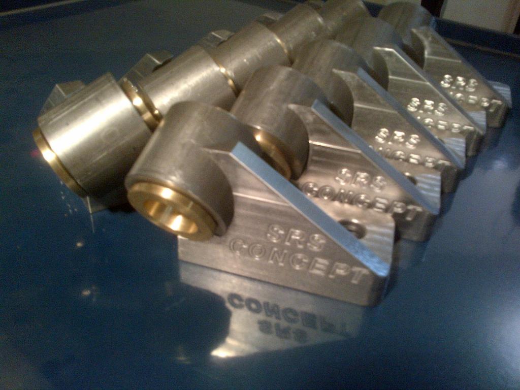

    I need to pick up a set to give me some more exhaust clearance, and they don't seem to be making them anymore. What gives?
    Can the e36 versions be used in their place?

          This is what you want
          Same as TreeHouse but you can get replaceable bushings for the Bimmerworld ones. The e36/e30 are the same thing, and they're not centered, they're offset.

              Those use the stock "lollipop" brackets, which don't offer enough clearance for my exhaust. Hence why I need the solid Treehouse-style design. Thanks though.
              I saw those, very tempted. So e36 fitment = e30 fitment? No different?

                  Kind of.....They're going to be offset, which would add some caster. they'd be like the e30m3 offset bushings Condor and others sell. Bolt up wise they're no different. They will allow for more room.
                  I had these but sold them and picked up some adjustable Lcabs from SLR. were the same price at the time. Also AKG makes some as well. They're just solid spherical bearings, harsh, but probably not much more that these guys would be.
                    Yep, e30, e36 and z3 are all the same fitment.
