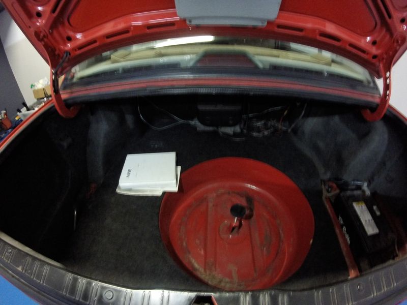

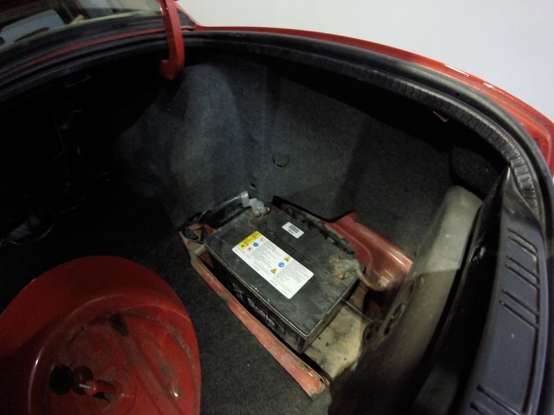

    Needs new battery tray (rusted)

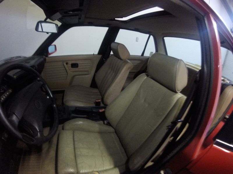

    New seat of any type to match (currently has 1 sport and 1 comfort seat)

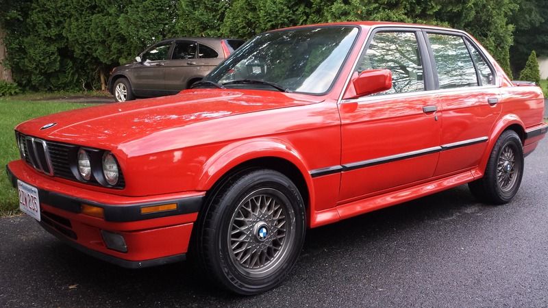

      Your right I should upload some pictures I will do so tomorrow after work. The body was repainted prior to my purchase. The paint job is decent but upclose clearly a poor spray can be noticed in a few spots. Otherwise from the surface or photo the car looks amazing.
      I will upload some pics tomorrow

          I think you could pay a shop to do the rust repair if it's just the battery tray, and a few other small spots. The rest, except the wiring issue, sounds like pretty basic stuff that shouldn't be too hard to do even if you're new to working on cars.

                  More details - I paid 4K for the car. It is an manual (i too did not want a automatic). It is a 4 door. Red new paint. Looks good. But again I think it is hiding some of the imperfections. I do not know much about mechanics. Have done typical minor repairs on other cars. Bolt on replacements. Etc... by no means am I experienced or close to an expert in auto mechanics. I have been watching DIY repair videos and repair articles.

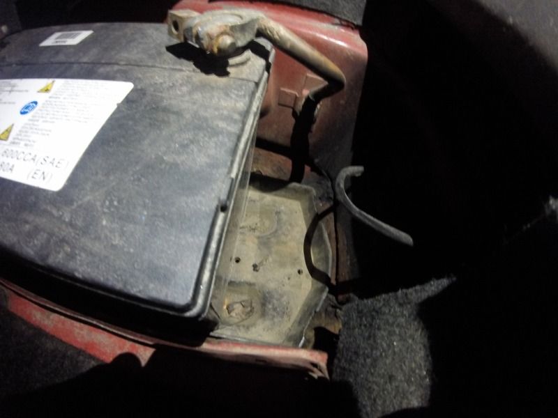

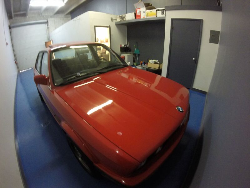

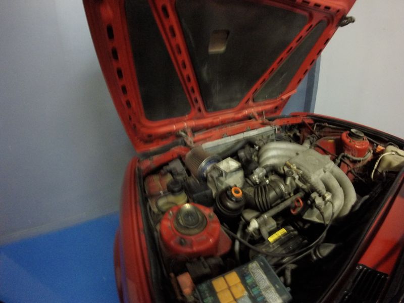

                    I have a few pics like this :
                    Pictures of troubled/qquestionable areas to follow.
                    • noid
                      • 1536
                      Its an E30, you need to fix stuff, and will consistently need to fix stuff. That is part of the fun.
                      Your resource to do-it-yourself and interesting bmw and e30 stuff: www.rtsauto.com
                      Your resource to tools and tips: www.rtstools.com
                      • Bbruins72
                        • Jun 2015
                        • 170

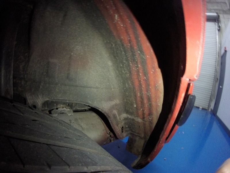

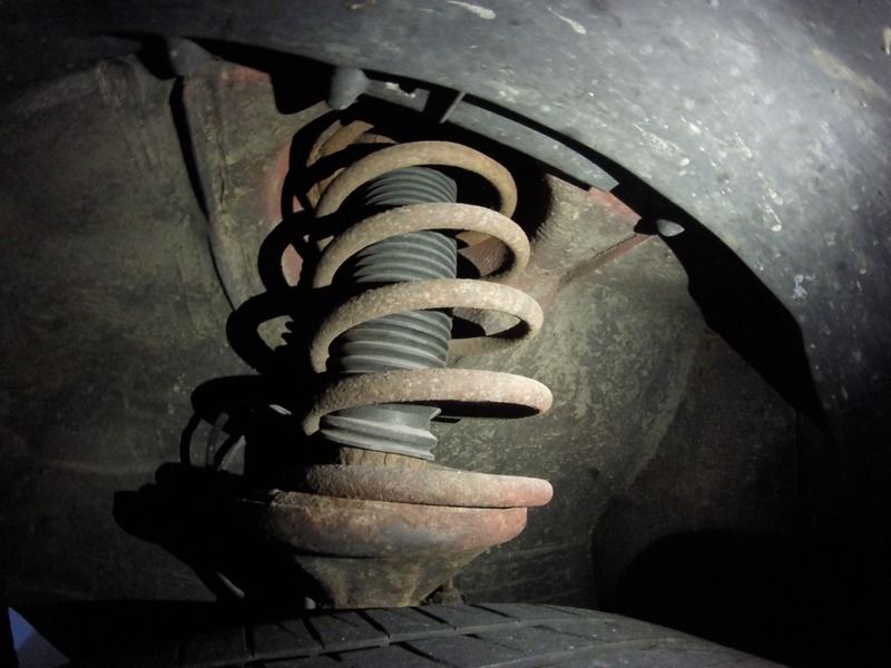

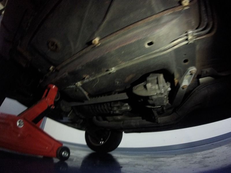

                        Pictures:

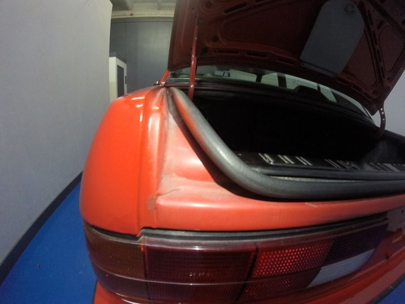

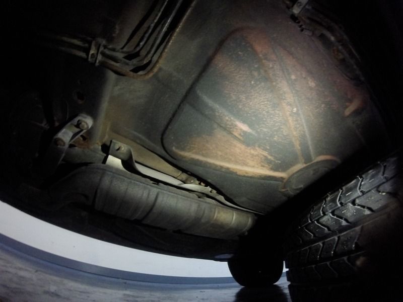

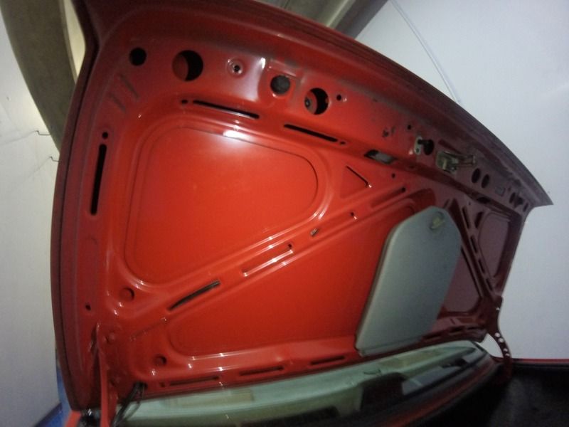

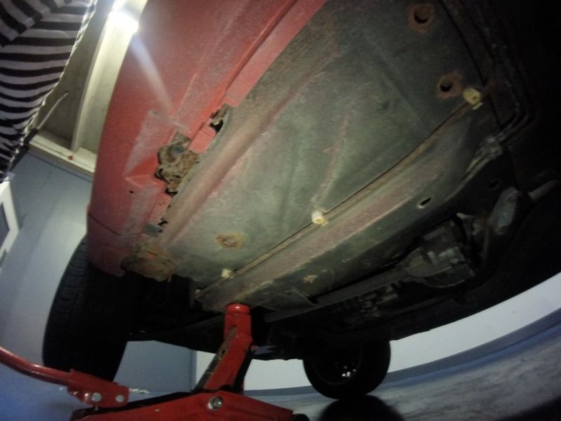

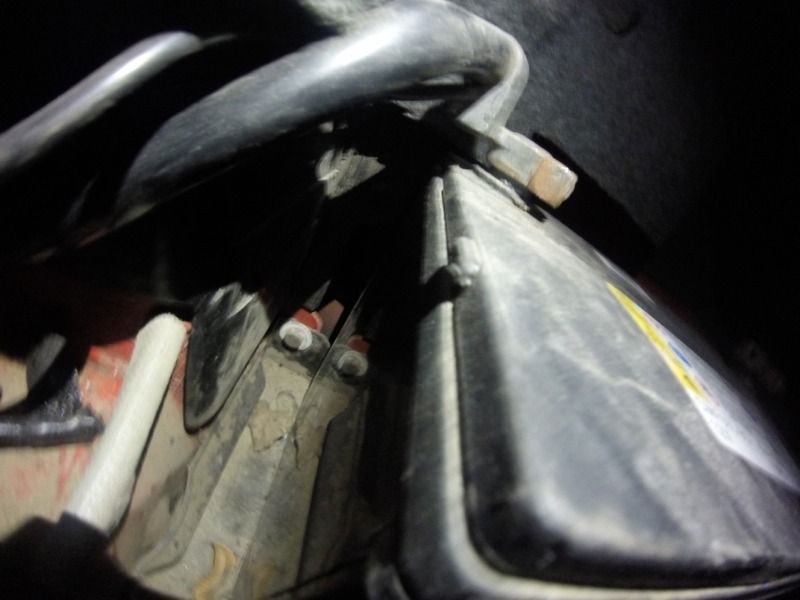

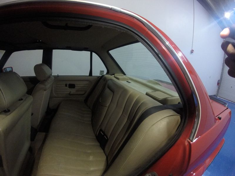

                          Few more pics

                            Check the rear spring perches, they tend to rot out on IX's. I would never take a e30 to restoration shop, they only work on "real cars". It really all depends on how much rust there is. Everything else is an easy fix.

                              I am hoping to get the car back from the shop next week. The guy at the place is an e30 owner as well. He is very knowledgeable and honest. I truly believe they are not trying to rip me off. In fact I never even thought that. I think they are just shocked by how nice it looked vs how it looked after the inspected it. I due trust the BMW tech and this shop.
                              He has told me he found Bondo type repairs from a possible front end accident. The carfax shows no accident. But again I am too much of a novice to know any better on what could be wrong.
