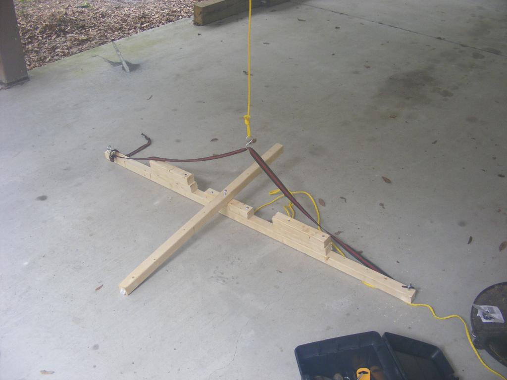

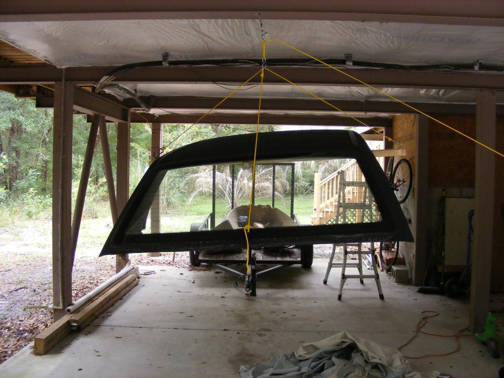

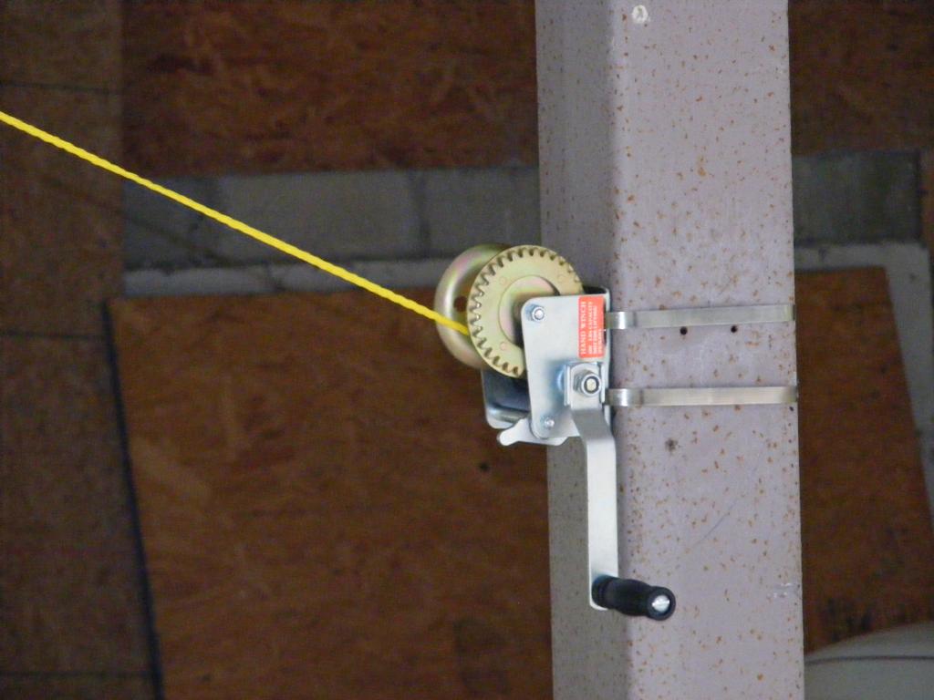

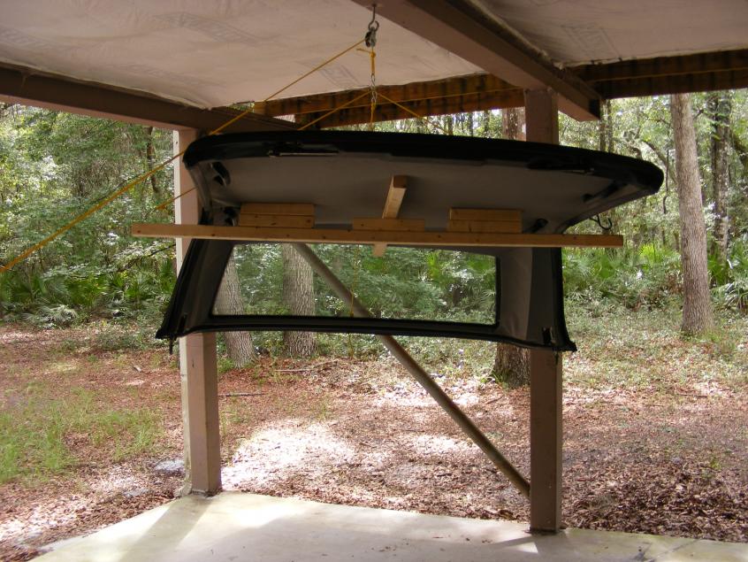

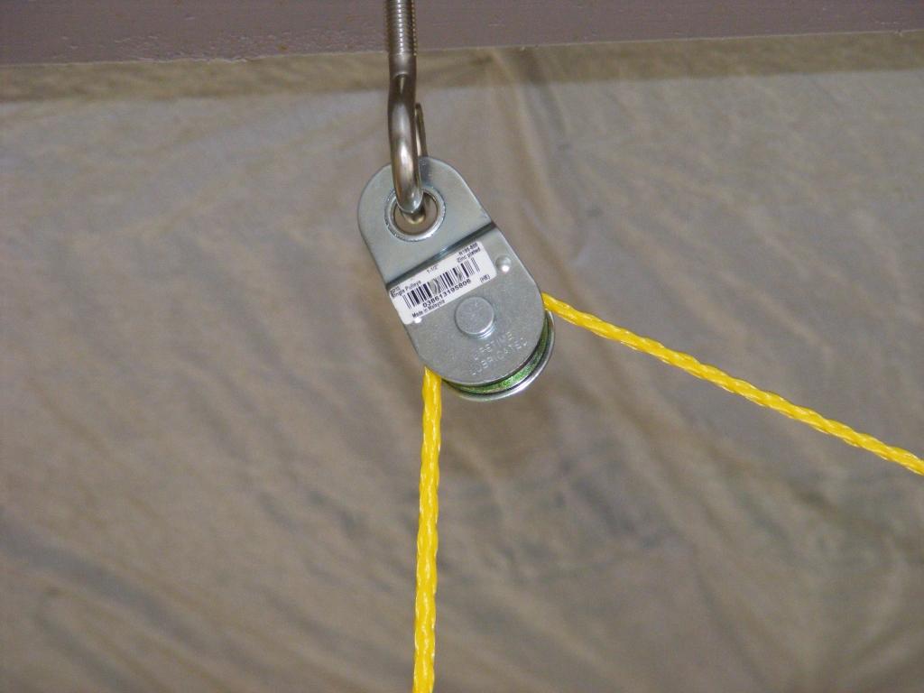

    Recently got a hard top so had to come up with a way to install by myself. Attached are some pics of my makeshift hoist. Built a cross piece out of some 2x2 and stacked it so there would be no pressure on the rubber trim. Installed a pulley above to a cross beam and then attached a boat trailer winch to a column to winch the top up and place it on my car. Works pretty well but not sure I want to store it in an up position when not on the car. Took a few hours and about $35 in parts. Happy with the results. Will work on a system that I feel comfortable with leaving the top hanging. The last pic is of the cross piece to lift the top.

            Had to do a few refinements like stronger hooks but it works great. Can easily install and remove the top by myself.
