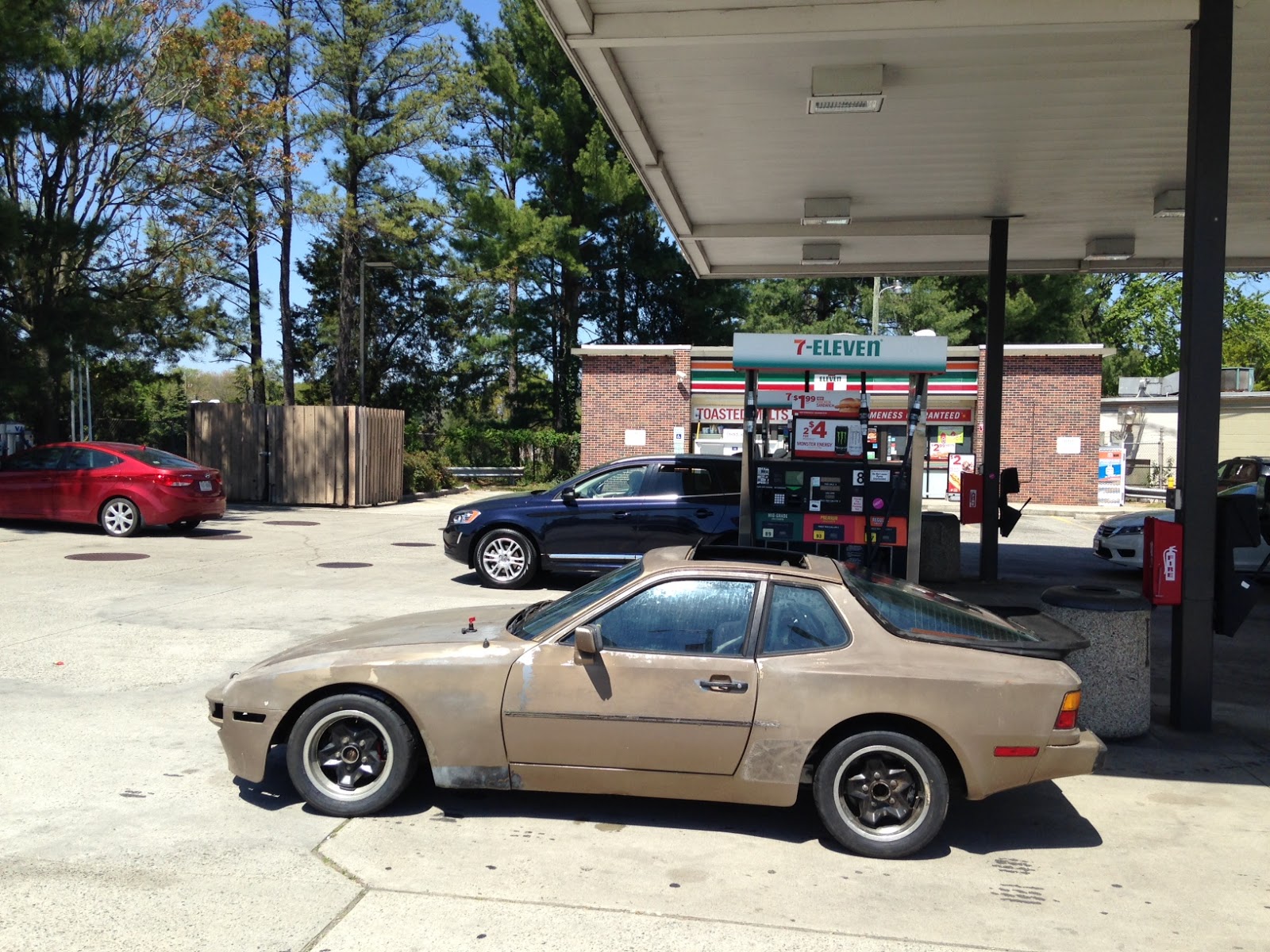

    Long story short, I'm building a 944 track car for HPDE events with my buddy. After getting it running the brake system felt like crap, so we ran through the normal procedures. Here's whats going on...
    Symptoms:
    Pedal is very mushy... to stop the car almost takes pushing the pedal to the floor board. Even when fully pressing the pedal it feels like the car has 20% of the braking power that it should. Brakes feel very, very weak. Car does not seem to be pulling to a particular side under braking.
    Previous attempts to fix that have now been deemed a failure of diagnosis:
    1. Initially began by flushing/bleeding brake system- did not fix the issue
    2. Replaced Brake Master, Clutch Master, and Clutch Slave Cylinders. Put in new fluid and bled the system again. - did not fix issue.
    3. One thought we had was that possibly the front brake calipers were seized open and were not engaging under braking. To test this we raised the front of the car on jack stands, took the wheels off, put a pry bar between two lug bolts, and attempted to move the wheel while the brakes were being applied. The thought was, if the brakes were pressed down, and the wheel moved, this meant the caliper wasn't functioning. We did this test, and the front brakes appeared to function as they should, and I was not able to move the wheels while the brakes were pressed.
    A third and final bleed of the system was done... which did not fix the issue. During one of the bleed sessions it appeared some small, solid rust chunks were expelled from the rear calipers. However, after that nice new fluid appeared to be flowing well.
    I don't know what I'm missing here guys... this is a simple power brake set-up without ABS or anything of that other high tech stuff. It should be relatively straightforward but for whatever reason this car's brake system is kicking my butt!!
    Thoughts??
    The car is a standard 84 N/A 944 (944/1). The braking system is not overly complicated and is similar to the BMW systems of the same era.
    A picture of the ugly POS as it exists right now:
