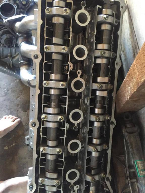

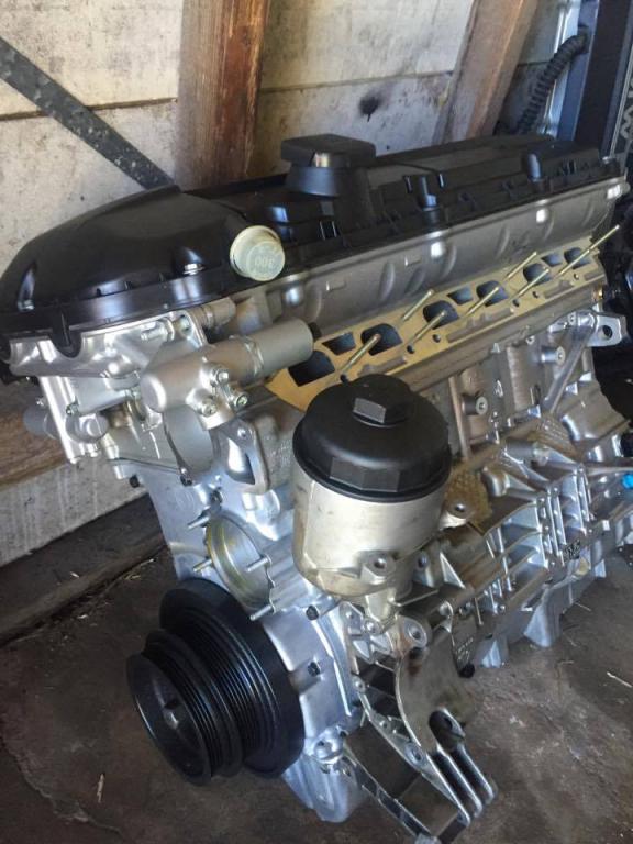

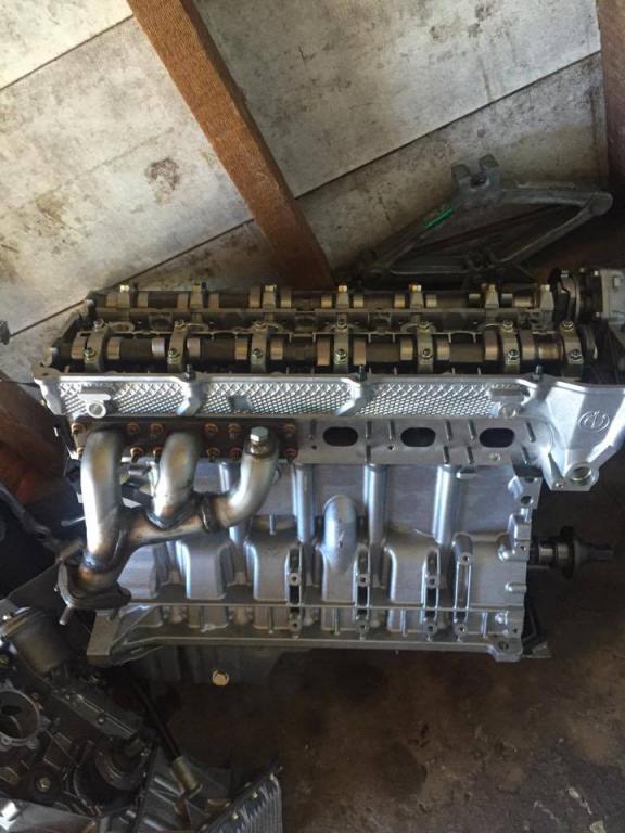

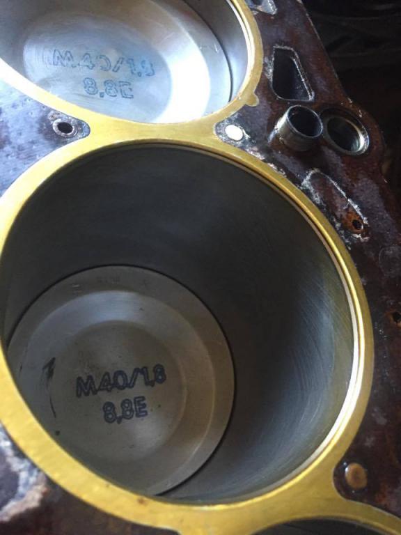

    Hey guys so I recently got my hands on 3 never started 0km engines.
    -M54B25
    -M52B20 (coffee table hah)
    -M40B18
    I am currently running a M54B30 in my car, its novelty has worn. What i am really wanting to know is, has anyone had success turning the 2.5 into a 3.
    Any advice would be great.

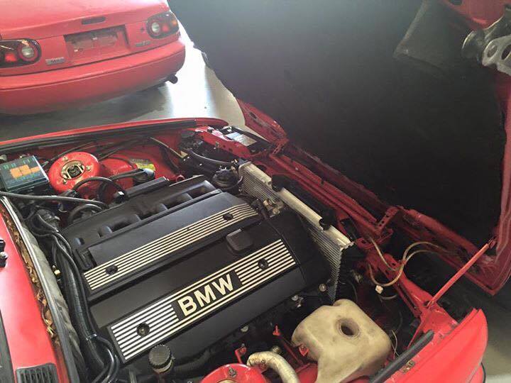

                  My car at the moment has a m54b30 with high km. I have a brand new m54b25 sitting here. Apparently 2.5-3.0 are compatable, suppose now i have to start buying turbo parts for a 3.0 je custom pistons and cant get any good info on best rod manufacture.

                      Yeah I have seen 2 in the workshop with that, I'm a BMW tech. Personally I wouldn't go as far as to say its inherent harmonic disproportion whether it be geometry of the rotating assembly or composition of the alloy its self. I mean the s63 twin turbo alloy v8 with a wack firing order seems to deal somewhat given the obstacles it has to overcome. Alot of the time phantom slackening and magical loosening can be owed to the domino effect of intolerance. Loctite and away she goes.
                      Trust me I don't plan on chucking old parts into a new block\head.. just wanted some opinion on new parts options if turning it into a 3.0 using new aftermarket parts maintaining b25 block and head is even possible.
                      The engine has been dismantled previously for tech info etc assembled at half torque so ill need to rebuild it anyway.
                      I run ms43?
