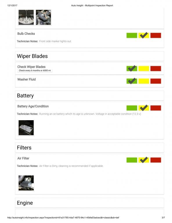

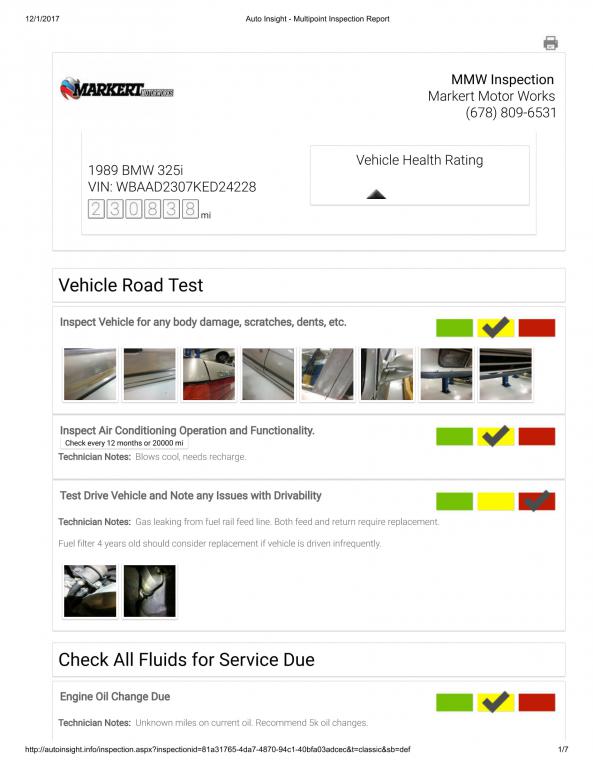

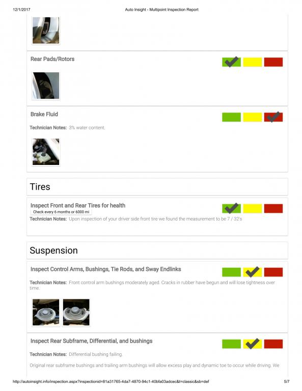

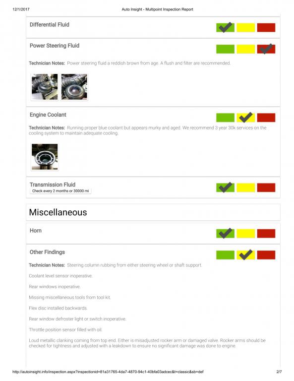

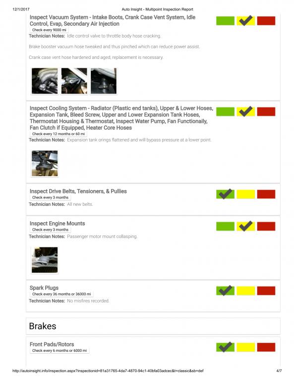

    The guys at Markert Motor Works (shoutout to Jordon and all rest of the crew for being super awesome) performed a PPI today and identified a bunch of stuff that I would have missed even in person. Nothing major, but a bunch of small stuff the car needed. I thought the car was a screaming deal (like I was already thinking how much it could get on BaT after I had my fun) but now it's a decent one.
    Y'all can check the PPI for yourselves attached. I think it is money well spent.

        Looks a pretty thorough inspection!
        Gives a bit of confidence buying sight unseen for sure - doesn't look like any deal breakers there... just some routine maintenance really.

                That’s a nice inspection. What about a compression/leak down test?
                • rtaq
                  • Apr 2017
                  • 57
                  Yeah, so I forgot to mention an important detail: the timing belt actually snapped on this car. Metric mechanic, however, pockets their valves so there is no interference with the pistons and use stronger rocker arms. The head was pulled after the belt snapped and apparently their was no damage. That's what is making me hesitant.
                  A leak down test would be a good idea but it'll cost $150-250 and I'm kinda over it by now.
