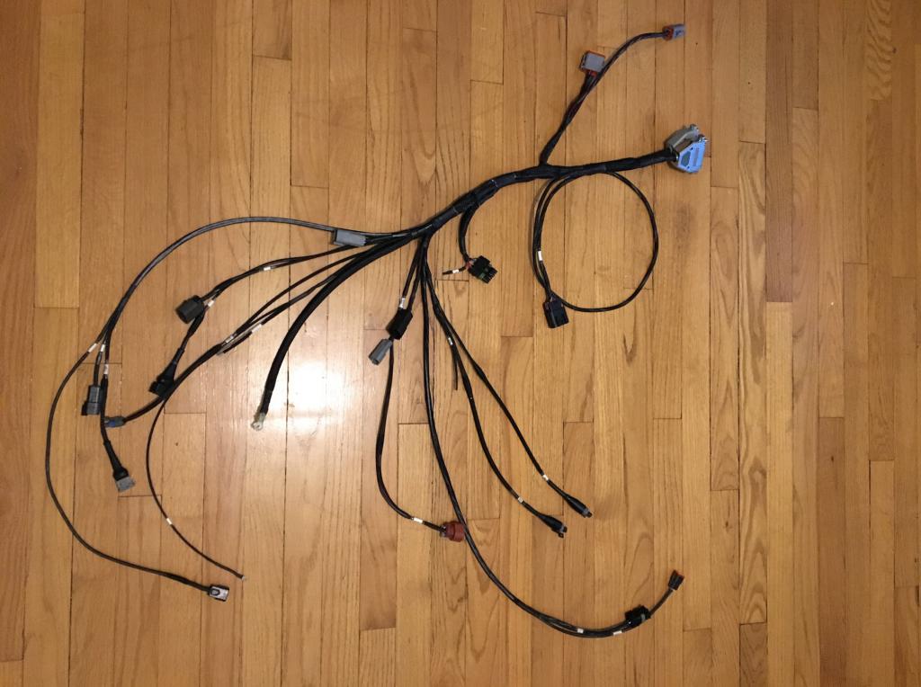

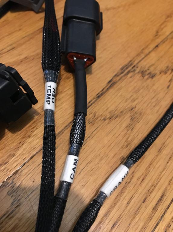

                  I would generally say that the cost of a new harness and complexity is hard to justify unless it is for a spec class, for example. Something as simple as placing a fuse panel can differ slightly from car to car, so it's hard to truly make a "one size fit all" harness that isn't the factory one. If you are doing it yourself, you're able to make decisions on accessories you'd like to have, and compromises you're comfortable with. A perfect example of this is your decision to keep the turn signal stalk or not.
                  For a quality motorsports harness you will be looking at 4 digits for sure, probably in the neighborhood of $4k-5k for a bespoke harness with quality components, labor and documentation included. With 10 uniform harnesses, perhaps it could be closer to 2k.
                  I cut up my 84 318 harness and still lost about 5 lbs. There's plenty more, but I haven't touched most of the under dash and fusebox area. The engine harness is on version 3 and still could use some work... photos attached.

                    @jaxxx nice work on that harness
