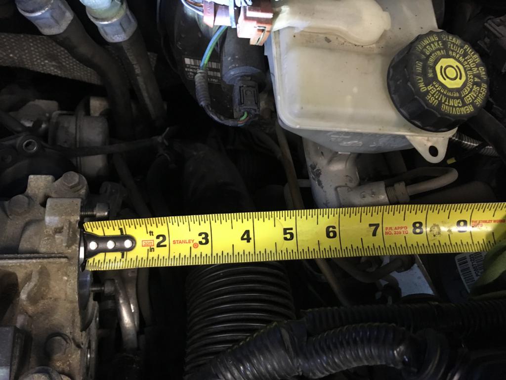

    There's about 6" of free space from the head to the ABS lines below the master cylinder to fit a drill in. Might have to get hold of a short case or 90ยบ drill. The turbo hose and all that can come out of there.

        I'll look into how much room a cordless Milwaukee or similar has at the head - some of those are pretty short. I need one anyway, and not sure who I'd borrow from and I hate doing that.

          I can mail you my corded makita right angle drill. shoot me a pm if you wish. do it right away though because its in my storage on the south side and we are staying down there tonight

            I have one of these drills for tight spaces like that.
            It works very well.
            Only 3/8” chuck though
            Edit:
            It’s probably the same as ^

                • flyboyx
                  • 8371
                  It works very well.
                  Only 3/8โ€ chuck though
                  Edit:
                  Itโ€™s probably the same as ^
                  thats the one I have too

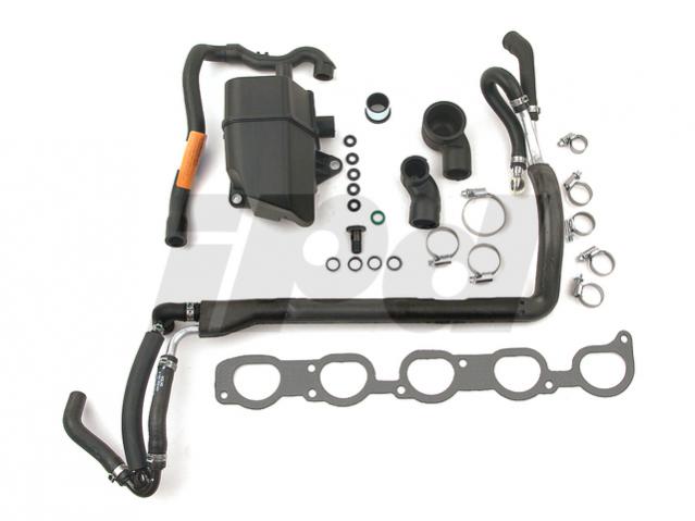

                    Everyone's already mentioned any idea's I had for you... but as a side note. Replace the Oil separator and all the associated hoses will be clogged as well so clean them out really well or replace them too... I guarantee you that that's why the cam seals are leaking, your new ones will blow out quickly otherwise. Very very common on these volvo's, I've replaced a ton of them and about half of them come with blown out cam seals if the issue is not caught in time....

                      SirMax, you mean the PCV system / oil separator box? It's the turbo motor. You think it's likely at 125k? I have all the records so I know it hasn't been done. I did this on my 850T, and it wasn't a huge job, just have to pull the intake and all that associated plumbing. I did the rubber glove test on the oil cap on this one and it was sucking in, so I thought maybe it was OK for now.
                      • SirMaxximus
                        • Oct 2014
                        • 180
                        Yes PCV system / oil trap / oil separator box. Its a common volvo issue, very likely at 125k, I've seen it as low as 50k..
                        Did it suck in quite a bit / have lots of vacuum on it? Same culprit causes that, In that case, you'll usually hear a hiss or a whistle with the engine running, if you pull out the dipstick the noise goes away and the engine will idle noticeably better
                        No its not too difficult of a job, some of them you need to remove the intake manifold. And some of the newer T5's you can get from underneath without removing the manifold... Either way, I've never seen the cam's leak on those without the Oil trap being the root issue, its entirely possible, but odds would be against it.

                          OK, good advice. No, it just pulled in a bit on the glove, slight vacuum. Passed the dipstick test. Everything else seems to have been maintained, but I noticed the PCV system was never changed.
                          $367, ouch. But it's all OEM parts.

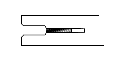

                                Here's a pretty close version of how it sits. That's a section view of the camshaft.
                                <EDIT> nope, it's a pdf file.....
                                Try this....pretty small....
Name:	Camshaft section.jpg
