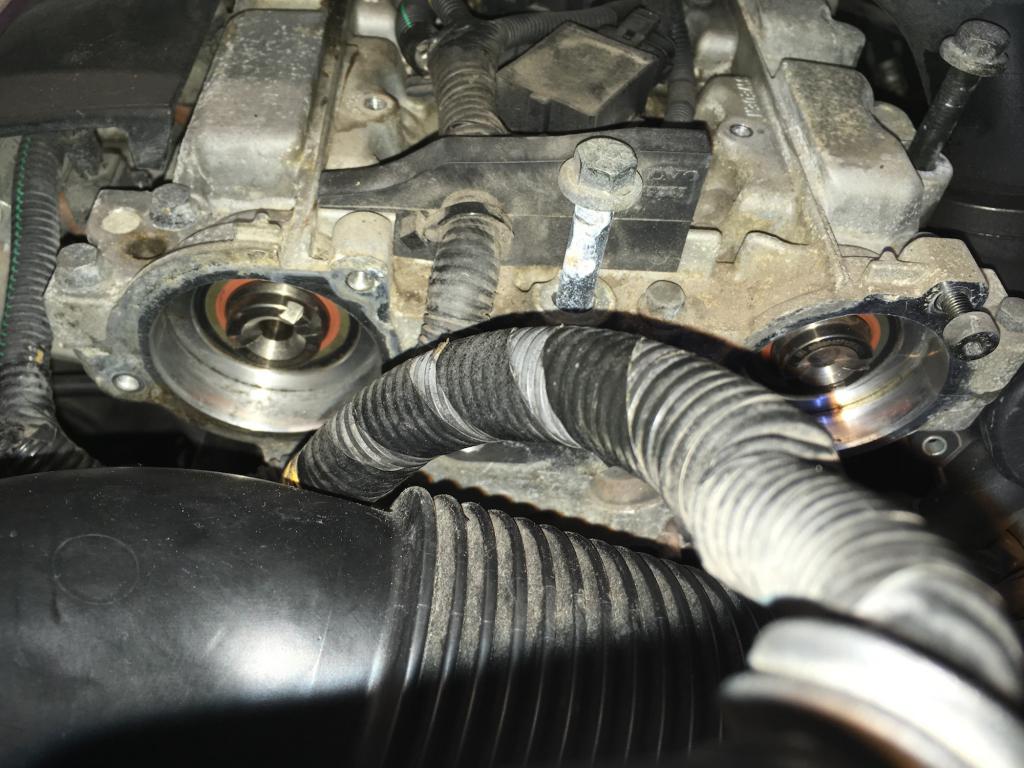

        Here is the situation.....
        This is the back of a Volvo head. I bought this car used recently with 125,000 mi and it's dirty. The front cam seals are leaking very badly. It has dual VVT. The upper motor mount, both cam position sensors, their covers, and the tone rings have been removed here.

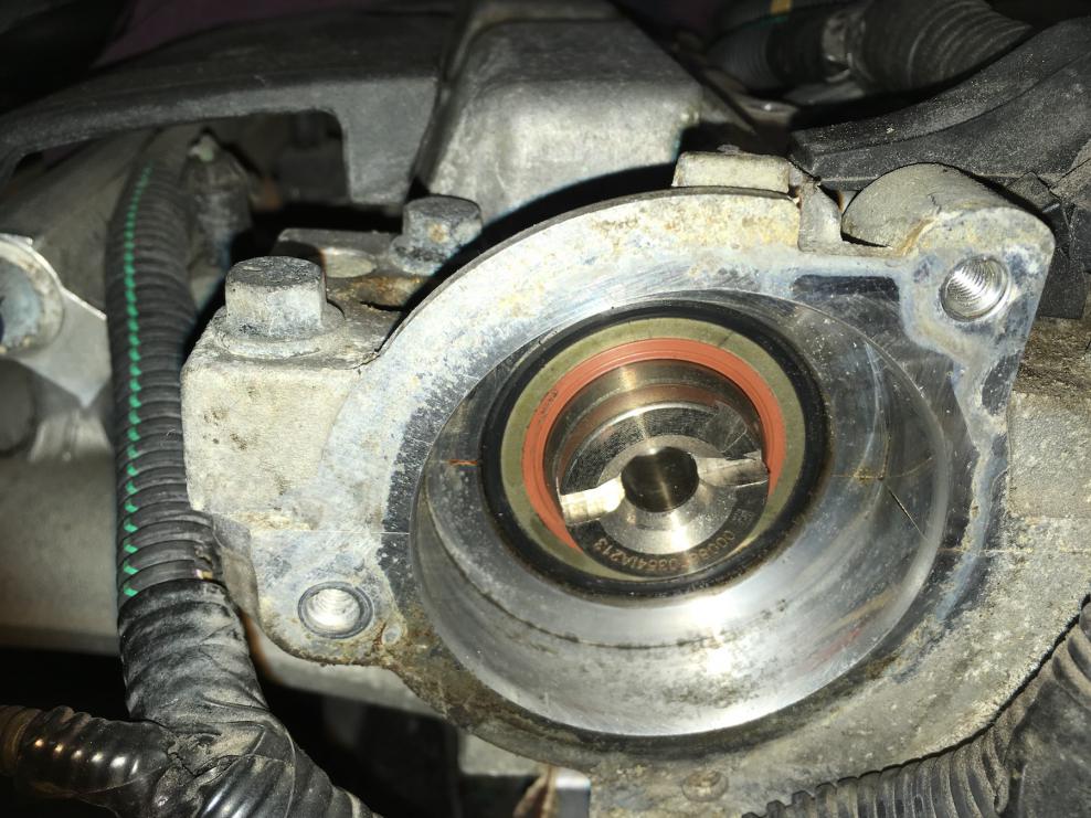

        This is the exhaust cam - the bolt end is inside that hole. Nothing to grab.

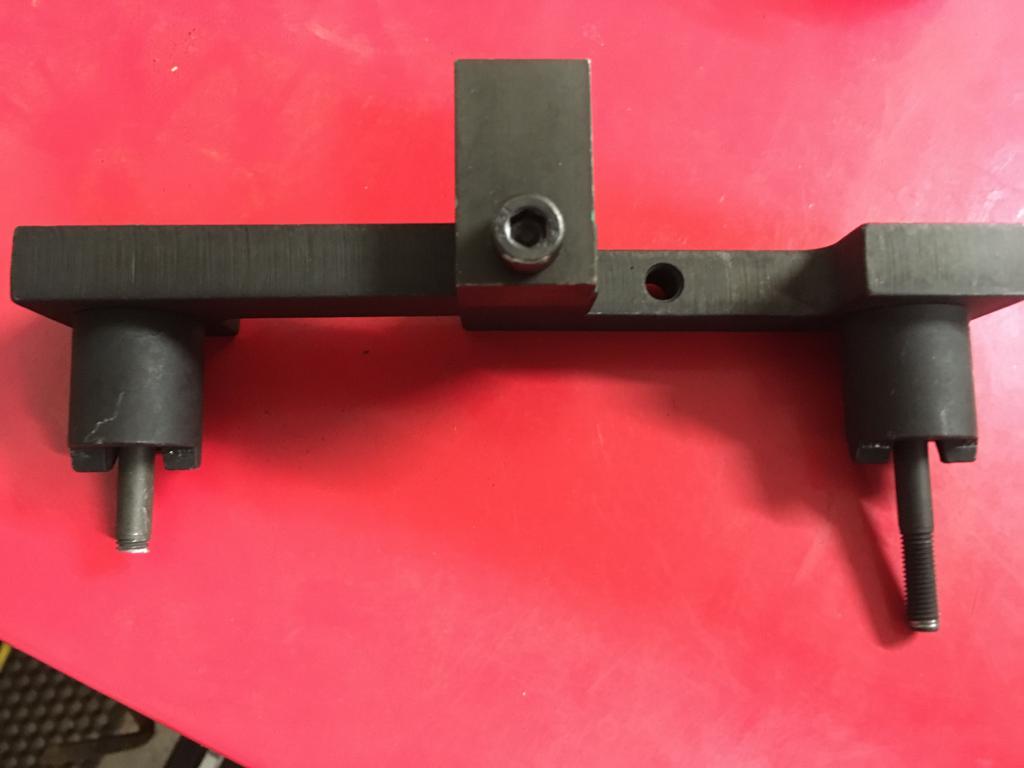

        This is the tool. The teeth lock into the slots in the backs of the cams to hold them while you mark your VVT travel.

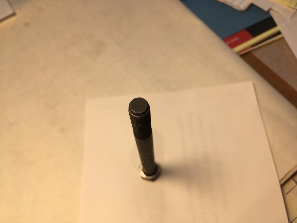

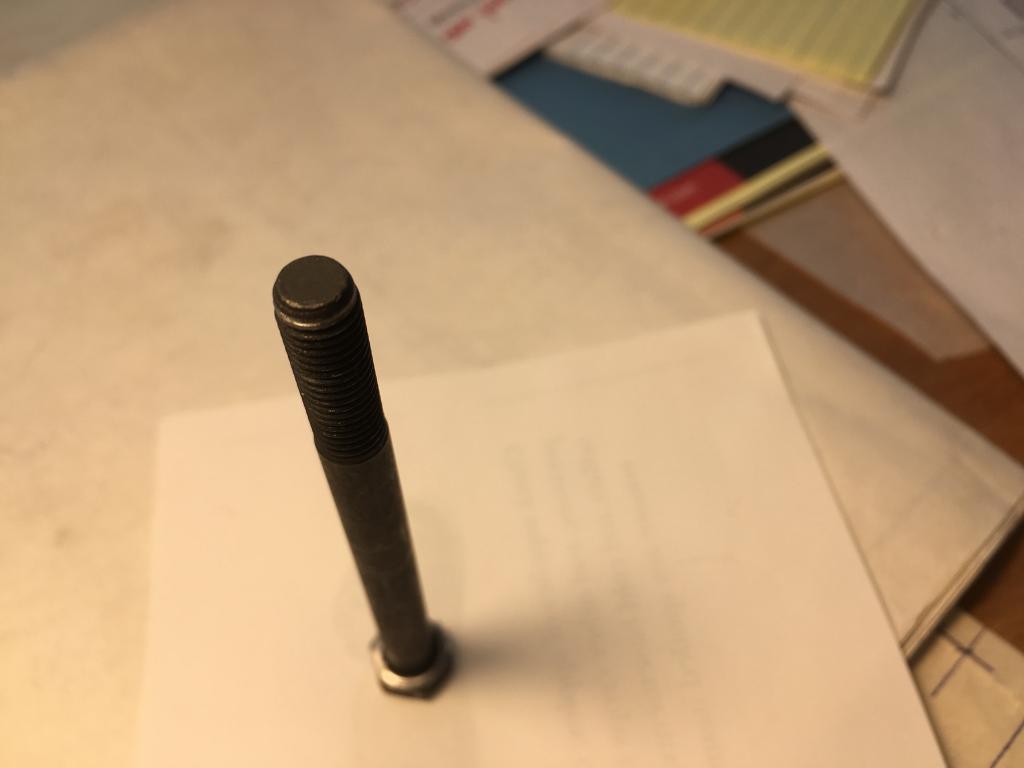

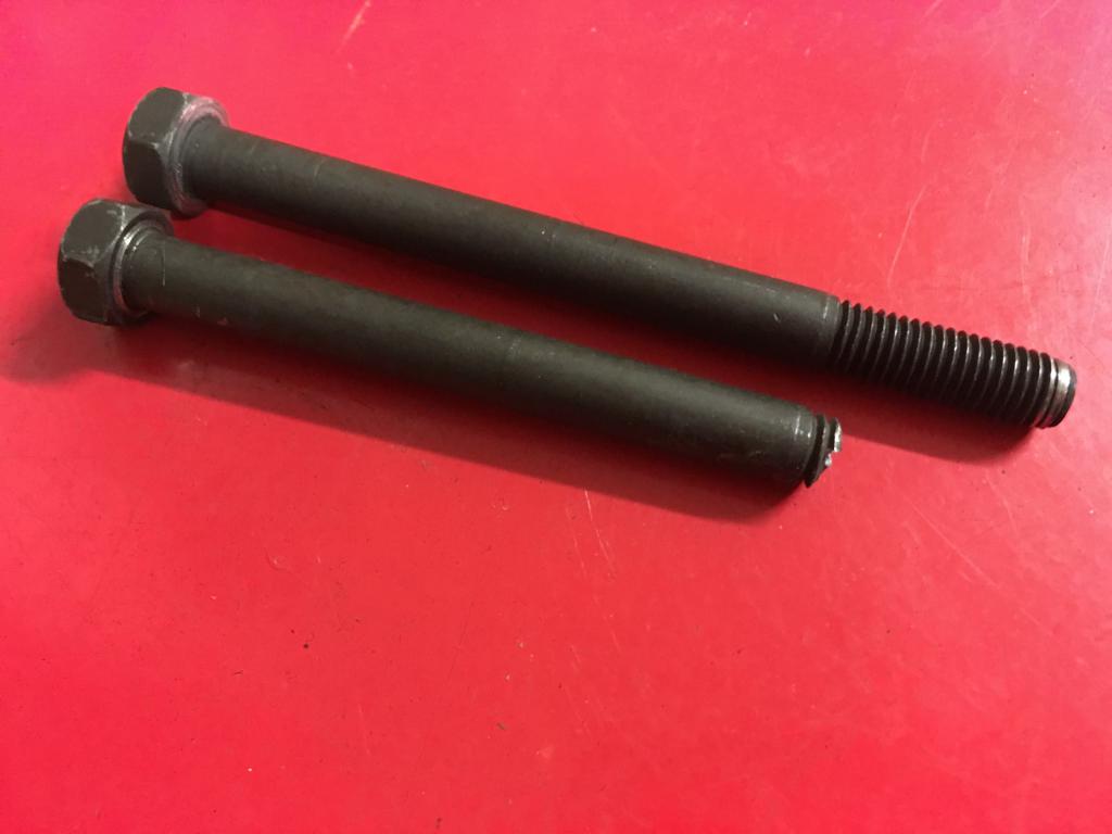

        18-19mm of bolt is missing. I'm curious about the markings on the bolt that didn't shear - was it starting to spin? Is it bottoming in the hole? Is the bolt too short and those are the only threads engaged? If only two or three threads, how was there enough torque to shear it off?

              WOW..... Depends on 1 thing, is the bolt thats left in the cam bottomed out or not.
              If not, then you stand a good chance of getting it out with a left hand drill, or at worst an easy out since the head is snapped off there should not be any pressure on the threads and should turn back out easily if you can get a bite on it. A very small yet powerful magnet on a rod might even do it if you can make something.
              If its bottomed out in the hole and there for pressure on the threads you might still be able to get it with an easy out..... Though be careful to not snap your drill or easy out off
              these assume your not cross threaded, which I doubt you are I would bet you get it this way hopefully with the left hand drill right off the bat, with the cam still installed in the head Vs the other option below.
              If thats not going to get it, your going to have to pull the cam and do some fancy clamping and securing in your drill press ( I assume you dont have access to a lathe) and progressively drill out the offending bolt stub until you can chase the last bits out with the correct tap, and restore the threads. Or take it to a machine shop and have them do it.. or just getting a new cam might be cheaper and easier
              edit : the non sheared bolt looks like it hit the end of the threads in the hole, does that mean bottomed out???? likely

                Something has flattened the last two rows of threads. The rest of it looks unmarked, like it wasn't even engaged. Could these bolts be way too short?

                  The end does't seem to be marked. Does that mean it's not bottomed, or that the threads are what bottoms?
                  Or....that's as far as it reached.

                    Well when you went to install them did they "thread in" or were they out of space in the tool it self as you attempted to install it?? that will tell you how much thread engagement there was
                    Looks to me like you ran out of thread, not necessarily out of hole with out looking down the end it hard to say which of the 3 situations is whats going on here..
