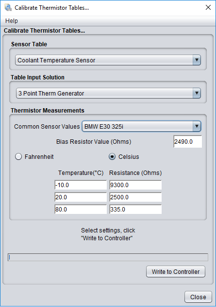

      Posting in case this is any use. TunerStudio thermistor calibration is currently set to use the following:

        Just realisdd the CLT and cluster sensors operate independently. MegaSquirt wouldn't have that info as it'd be handled solely by the gauge/cluster.

          pretty sure I have this in a PDF somewhere. However, good luck finding it.. :(
          But yeah, it's a different curve from the sensor that runs the engine.
