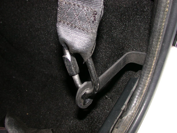

              Originally posted by 1991 318is
              A belt bunched up like that was one of two main factors in Dale Earnhart's death (in addition to no Hans Device).
              From CBS Sports report on the final results of NASCARS investigation:
              " This meant the adjuster mechanism became cockeyed -- the lower end moved forward -- and the webbing in the left side adjust mechanism bunched up toward the lower end of the mechanism. Belt webbing works best when it remains flat and all of its fibers are pulled at once. When a belt dumps, a greater stress is placed on fewer fibers, and there is a greater risk of tearing. .... the manufacturer contends that had Earnhardt's belts been installed at a proper angle, it may have helped stop the chain reaction of events that led to the ring fractures at the base of his skull that was responsible for his death. "We provide every competitor with a set of instructions how to install the belt," said James H. Voyles, one of Simpson's attorneys. "If you don't follow the set of instructions with a manufacturers product, you may encounter a problem."
              The installation pictured above is some real stupid sh*t.
              That was more or less my thought on this. The belt being bunched up at the end like that is bad. You need to figure out some way to hook it on flat. I suggest you do what Jordan did:
              This is the best way IMO to do it.

                            Originally posted by 808BMW
                            Eric, where is that bracket mounted to? On my car, it's mounted straight up coming from under my seat (stock for a 4 door?) I've never been inside a 2 door e30, so I don't know how that is setup.
                            The interior plastic pieces are crap. My dad's e39 pisses him off with all the little buttons breaking.
                            Wow, that looks pretty dangerous. Why is it mounted that way? Just to have a harness look? I have Corbeau TRS' in my car (is that what your driver seat is) and the stock belts work fine.
                            honestly its cuz im lazy. i have been meaning to throw a factory seat back in but cant find a good one, also i had to replace my seatbelt for another one, (long story why) and well never got around. i have to do this soon though, cus its a big nicht nicht mit die Polizie
