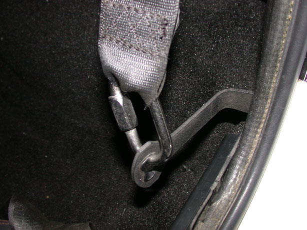

    I have 4 point harness in my e30 coupe, but I never wear them anymore after hearing about how a 4pt harness will actually hurt you in a rollover unless you have a roll bar or a 4 door sedan with a solid B pillar.
    I always buckle up. Do to my Vader conversion (The Vaders are mounted to 3/8" steel brackets with hardware. The brackets mount to the OEM seat points with stock hardware), the seatbelts setup is as follows:
    Stock e30 seatbelts plug into Vader buckles. Since I had to remove the seat belt bar from my coupe, I put in the smaller 4 door e30 seat belt bracket. The bracket mounts to the OEM location and the seatbelt is attached to this bracket with a thick metal link. The link screws apart on one side which is how I got it to loop through the seatbelt and seatbelt bracket. At first, I was worried about the link, but it feels and looks more solid then the stock e30 4 door seat belt bracket that I am using. I figure if the 4 door bracket is rated high enough to hold up in a crash, the link should be more then enough. See the picture below:
    So,
    1. How safe is the e30 really?
    2. Care to share your personal experiences?
    3. How safe is my e30 with my custom seats and seat belt setup? Can I do anything to improve my setup?

    I wouldn´t trust that attachtment arm unless it was made from titanium,
    in the 4door that bracket isn´t angled like that is it? I think it´s pointed upward
    In an accident that will bend rightaway,

        In the cabrio, the arm is on a hinge that moves forward when the driver buckles up.
        I'm not sure how the bracket is in the 4 door, but I do think it points straight up.
        If I had it pointing straight up like a stock e30 4 door, the bracket would bend forward in a wreck and there would be slack in the belt. I have mine angled so that in a wreck, there is no way for it to bend.
        Think for a second about the seat VS bracket positions in the coupe and sedan. In the sedan, the bracket is parallel to the driver which means in an accident, it will torque up. Therefore the bracket is mounted pointing up so there is no way for it to bend. In the coupe, the bracket is mounted behind the driver. In an accident the bracket will torque towards the driver so I mounted mine pointing forward. As I said above, the cabrio bracket is on a spring. The bracket shoots back to allow rear seat access in the cabrio, but pulls forward when the driver is wearing his seatbelt.
        The bracket does seem flimsy. When I pulled them out of a wrecked e30 4 door in a junkyard I had my doubts. But if these things were OEM I guess they are safe.
        Really the only thing not OEM in my setup is the clip that connects the brackt and belt. It is rated at 2,000 pounds according to the package and seems more hardcore then the bracket. I really don't see how this could be a problem, but if it is, I'd like to know why. I'm getting my degree in Business Management not Physics.

            I generally feel pretty safe in my E30 ('87 325is- so no airbag). BUT, I would feel safer in a car with airbags, and I have seen enough airbag-equipped E30's to know that the airbags often don't go off when they should. I don't know if this is due to age, or bad controller/sensors or if someone had messed with the airbag system or what, but it's what I've seen.
            That said, I was with my mother-in-law about 1.5 years ago when she was buying a new car (2005 Honda Accord to replace her 1991 Accord which she bought new in 1991...). The salesman was trying to sell her the V6 and the alloy wheels, etc, etc, but she wanted the basics, with a sunroof, AC and a stereo with CD player as the only options. When it came time to decide whether to get the side curtain airbags- an extra ~$800 or so option, she asked me my opinion and I said "definitely get them". Airbags are a PITA to replace or repair when you're working on a wrecked car, mostly because they cost $$$$, but I would get as many airbags as I could in any new car I bought- IF I ever were to buy a new car... :)
            But basically, E30's are solid cars, I've seen plenty of wrecked E30's and they hold up much much better than most other cars- you can wreck an E30 and say a Pontiac Grand Am in the front at the same speed and I'll bet that the Pontiac's doors are jammed, or at least tweaked enough that the door does not close anymore, but the E30 doors will work just fine. It takes a really hard hit to bend the roof on an E30, not so with lots of other cars.
            As for your seatbelt setup, it looks to me that the weak point is that steel chain link- it might be strong enough, but I'd look for something stronger- maybe something that was forged.

                  Lukas...please, upgrade that link to something rated for ATLEAST 5000 lbs. When I work construction and wear my harness, everything about the harness has to be rated to withstand a 5000 lbs load (and this is for a guy that weighs 150 lbs). The harness would only allow me to fall a full 6 feet before I would be swinging and yelling at people to get me down. You would be surprised at the amount of force an object can exert (?) when it is suddenly stopped.
                  Just my .02
