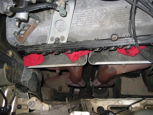

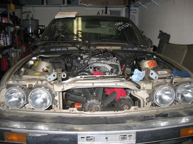

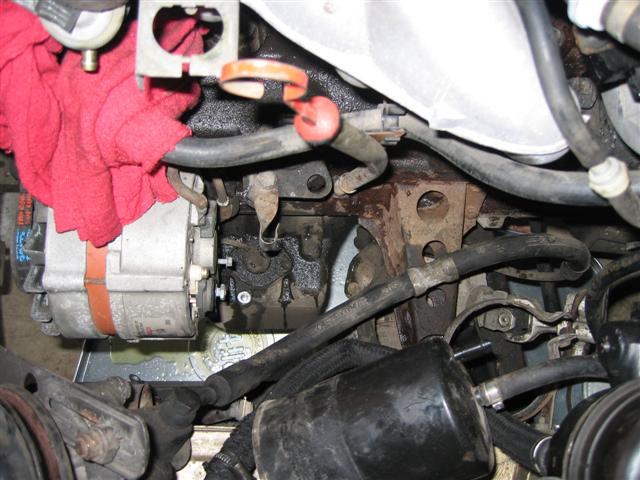

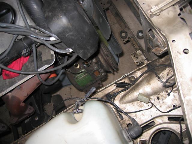

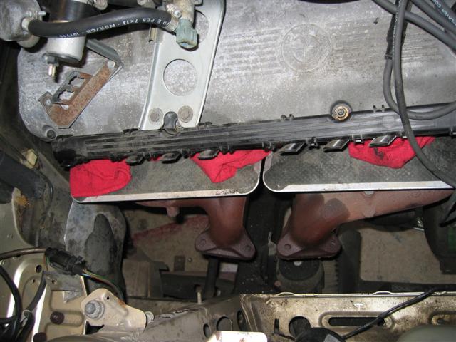

                    oh yeah, what would a thread be worth without crappy pics?Click image for larger version

                    • browntown

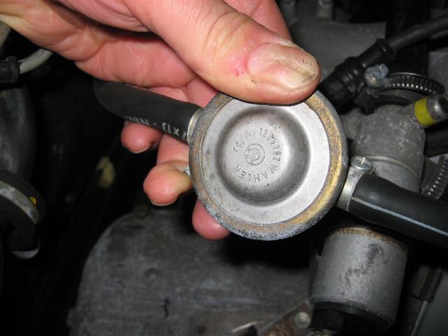

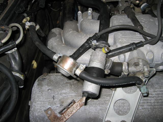

                        What year engine is this? I ask because in this pic here.....
                        You see that one fuel hose going to the cold start valve? What is that silver looking canister thing at the other end of the hose? It is half cut off by the pic.
                        Mine does'nt have that.
                        Originally posted by Kershaw
                        • browntown
                          • Jun 2004
                          • 3524
                          it's an 85 "e", are you talking about the doohcikey attached to the hose? no idea, probably a check valve or a restrictor -- cant find it on realoem, the shiny one on the bracket is the idle control I think. Let me finish this stoli and tonic and I'll mosey out to the garage and take a pic for you.

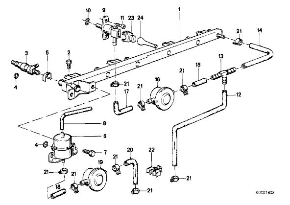

                              i'll get you a pic but I think it's #16 in this diagram, oddly realoem says my car doesn't have it or #19 but it quite obviously does. Must not be that important.
                              I found it, on early cars 16/19 are ambiguously labeled "connection piece", drops after builds in late 84.
                              16 CONNECTION PIECE 1 09/1984 13311713470 $1.67

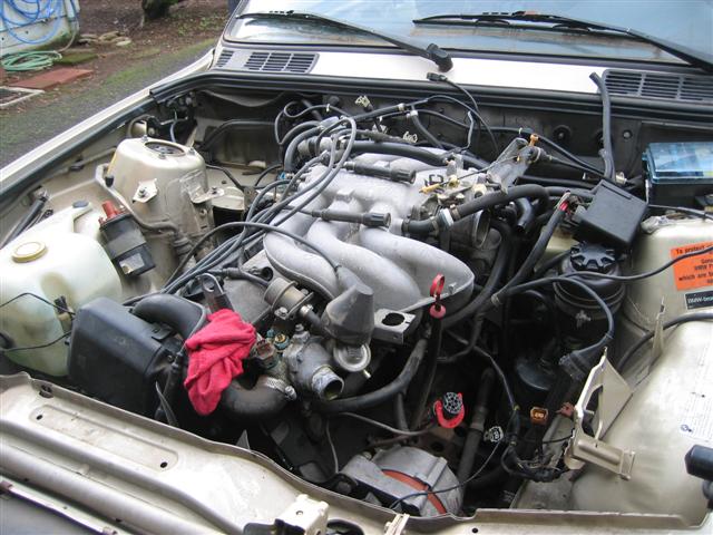

                              edit here's some pics:Click image for larger version
