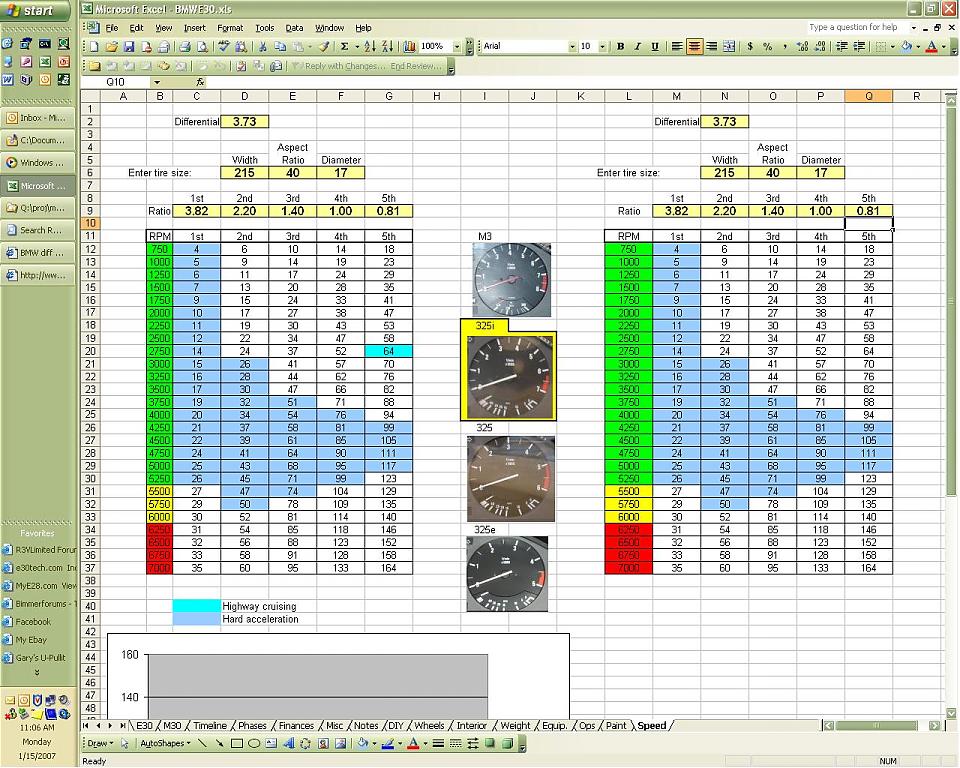

                http://www.f-body.org/gears/
                • Garageaholic
                  Freestyle Fabricator
                  • Dec 2005
                  • 5204
                  I have created an excel spreadsheet. Anybody want it, just email me and i can send the excel file. here is a look at it
