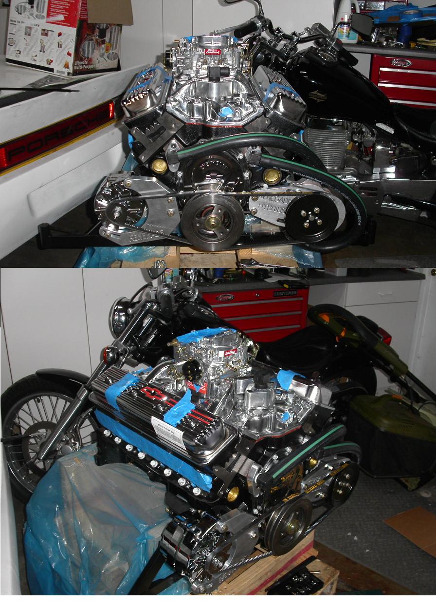

    Below I believe is a 330 HP crate motor, Must be nice in a car that only weighs 2000 lbs!!! Plus with 911 suspention, huge rotors off a 911 turbo, and low CG, it must be a kick in the ass to drive.
    Brand New Chevrolet 350HO, 350 cubic inch, 330 horsepower Crate Engine
    This is a Brand New 350 cubic inch small block Chevy crate engine that pumps out an honest 330 horsepower. With it's 4-bolt main block, nodular iron crankshaft, PM steel connecting rods and light but strong cast aluminum pistons, this engine screams durability. Add to the strong foundation a pair of 64cc Vortec cast iron cylinder heads and a dual pattern camshaft with just a bit of a "lopey" idle, and you've got the muscle car small block that you've been looking for. Dressed to impress with chrome valve covers and timing cover, this engine will look great between the fenders of your favorite street rod, muscle car, or grass roots racer.
    The cylinder heads on this great little performer use 1.94" intake valves and 1.50" exhaust valves that are sprung with 1999 L31 valve springs. The 64cc combustion chambers yield a healthy, but streetable 9.1 to 1 compression ratio.
    The camshaft is a modern dual pattern interpretation of the old '65 to '67 Corvette camshaft. But with more lift and duration on the exhaust side, it does a better job of clearing exhaust from the combustion chamber. We also decreased duration and lift ever so slightly on the intake side to build more cylinder pressure. The result is a camshaft that makes great torque and horsepower with the 350 HO's 9.1 to 1 compression ratio.

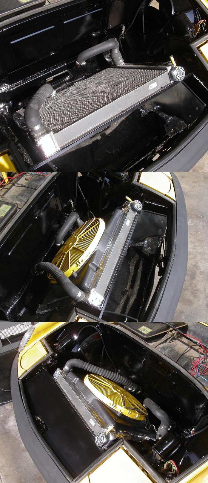

                  yes it does. Just the block is turned 180 degrees from "normal". I E, in our cars the front of the engine faces forward, but in the 914/ v8 sway, the engine sits backwards. Most of these have the rad. up front with lines ran along the tunnel or down the rockers on either side of the chassis.

                    Engine is actually in the mid section of the car, so the front of the block is still positioned towards the front of the car. If it was rear engined, then the block would be turned 180 deg.
