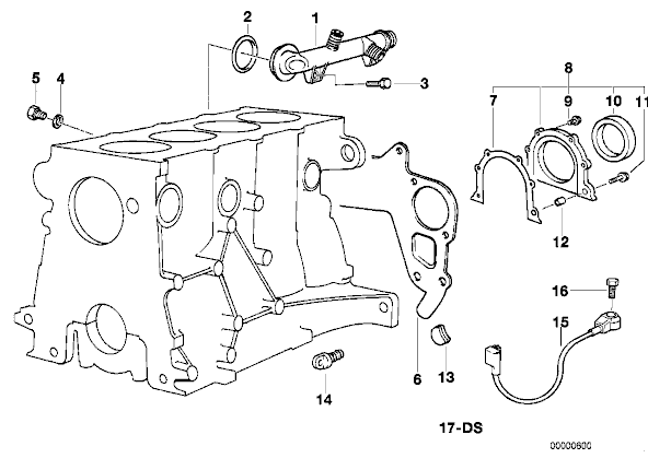

    I need the circled item deperately, on RealOEM.com it doesn't have a corresponding part #.
    http://realoem.com/bmw/showparts.do?...72&hg=11&fg=35
    Any help would be great I need this part stat, I drive around 200mi a day, so time is of the essence.
    Thanks, Bryant
    E30 325ix 62k

    WTF is that system that it is in? I don't recognize it at all...

      it might be part of the oil cooling system

        m42 cooling system/ not oil.

          holy fuck there is like a tube to cool the fuck Throttle body thingy.

            Part number 1.
            11 53 1 714 738
            You'll need the gasket too, 11 53 1 709 157
            http://www.realoem.com/bmw/showparts...54&hg=11&fg=10

              it's actually to heat it up for faster warm up time in cold weather.

                Damn, I'm NOT losing my mind...... :)
                I *KNEW* it was in there somewhere, but I could not find it anywhere. I even looked at that same diagram but didn't see it!!
                Leave it to BMW to put a part of the cooling system in with "Engine Block Mounting Parts".......
                • FredK
                  • 14752
                  Haha I didn't see it either, at first.
                  So, I went to Pelican Parts, found the PN, and used RealOEM's PN search to find the diagram. :)
